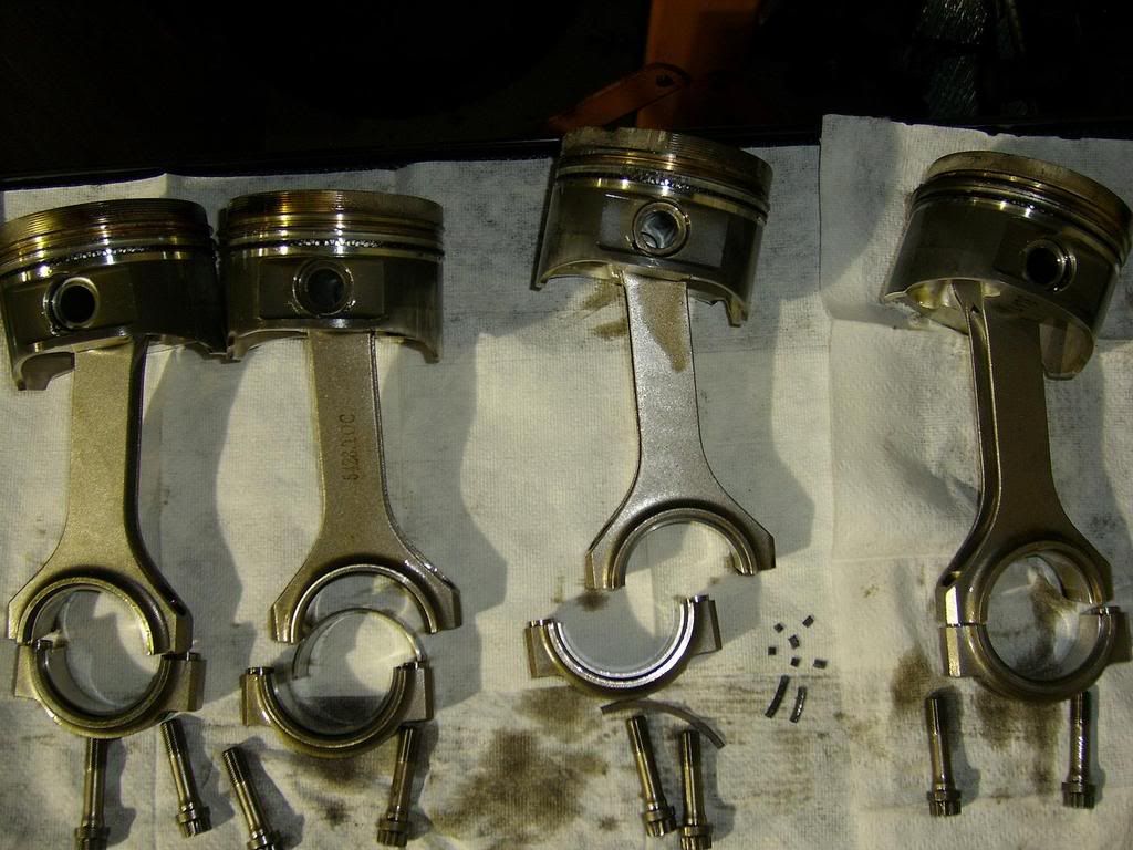

Last Sunday I got the Alltrac running again. It was down for a couple months for a head gasket job and some other small things. So anyway, did some tuning and it was running great. Later on that night on my way home, I was doing a 3rd gear pull, heard a "boom". The car still drove just fine and boosted good. I came up to a red light and heard a knocking sound that sounded like rod knock.. shit. Took it home and parked it. Compression test: 160, 120, 110, 150. Hmm.. engine is coming out.. again.
Pulled the engine out last thursday and I didn't open the engine up until tonight. Here is the extent of the damage.
At least my Eagle rods are still able to be salvaged!
