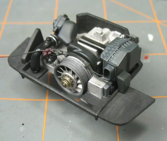

Looking good, Andy
I like your "wiring jig" - good idea.
For the 90-degree plug boots, you might want to visit your neighbor at RMoM
I picked up some of his 90deg boots and they are very nice! (I also picked up some spark plugs )
Another thought that came to was using the plastidrip(?) stuff that Robrex uses on his 1/12s. The effect in that scale is bloody awesome but I don't know how it would work in 1/24...

two quick things:
in this pic
the tube/pipe that goes into the air filter is circular with a bit of a bend in it.
the small opening at the front of the airbox is usually a (shiney) metal part, which apparently makes up part of the "induction kit" that they charged a couple of grand for.
other than that, nice job.

Yup. Looked at a friends' and your firing order looks correct. Nice.

Originally Posted by 360spider
Andy, what is the rationale behind this?
Because it goes on smoooooth, and so I have to put very little effort into polishing it. I loathe micromesh, and I'd rather put the patience and effort into application instead of grinding out orangepeel.
Thanks! Nice to have it verified.

The Revell/Italeri 911 Turbo is largely incorrect....
The body in the kit is the same as found in the normal 993 carrera kit and while different sills are included, it doesn't actually have the wider rear arches (memory tells me the rear is wider by 30mm on both sides).
The chassis is untouched from the 964 kits so the suspension is wrong.
The interior is also untouched from that kit so, as you have noted, has some of the wrong details.
The engine part is also untouched from the 964 kits and as shown here, has the wrong fan and none of the variaram parts/detail.
The wheels are the wrong size.
Errrgh! But thank you for the info. I didn't know that the suspension was also wrong.
