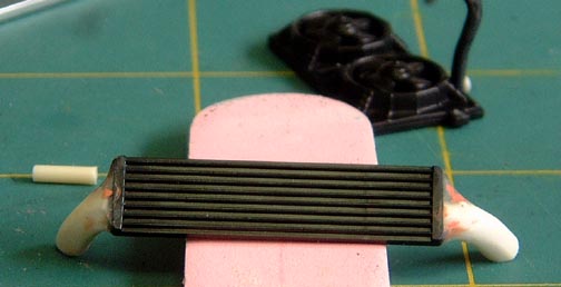

More images.
First one is the intercooler being constructed of CA , tubing, and spot putty form Bondo.

Fullbloodchop: I got your e-mail. The parts for the turbo are 90% built from styrene tubing in assorted sizes. The other pieces were made from styrene sheets. I don't have a build up of the components. Takes too much time to keep updating. The best I can do is just look at the detail pics that I posted previously. Use your imagination and creativity. Its not that hard. If I remember right, I think the whole turbo system took about 3 hours to make. Including the intercooler.
They're just plastic tubes that are cut to size, glued together and with a little heat they'll bend. Takes practice though. Try cutting pieces off the disposed parts trees and heating them to learn how the styrene reacts to heat and how much heat to apply. BTW-these tips are for making the snail portion of the turbo body.
Oh, I forgot to mention the CA glue, CA accelerator, Gunze's thick primer in a bottle, and Bondo's red spot putty to help in shaping some curves and as filler.
