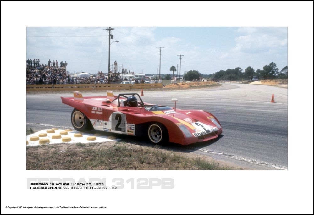

As hemi killer already wrote, the surface of that particular car appears to be flat, like Tamiya flat aluminium XF16.
BUT the most important question is: Does that particular picture / car (actually seems to be shot at Spa Francorchamps nowadays while a classic meeting or oldtimer GP) show the ORIGINAL car in ORIGINAL condition OR is it restored?
I have the same "difficulties" with my current project, the Porsche 917LH. There are lot of pics showing restored ones and original ones..........if you are going for a "authentic" build, i suggest you to "be careful with pictures like these". It's also about the decals / stickers.
That's no look of 1972-car (for sure it is a real 312PB). Try to catch that mood / feeling of the time you want your miniature to take place in.
Don't you have some more pictures showing the car while the depending race at the Nürburgring in 1972?

I googled around over the last weekend and there are some pics showing the depending 1972-Nürburgring-car(s), but it's hard to imagine the surface / the appearance of that area......unfortunately.
Now here's a pic from 1972, showing the Andretti / Ickx - 312PB at Sebring.
SEEMS to be a bare metal surface, like at old jet-planes?!
When you now think of (brake-)dust, dirt, hot air and things like that covering that metal-area you might get that flatened look.
This is just my opinion.
I know, you'll give it more than justice anyway!!!! However.
Keep it up, "do what YOUR feelings, heart and mind tells you"!
