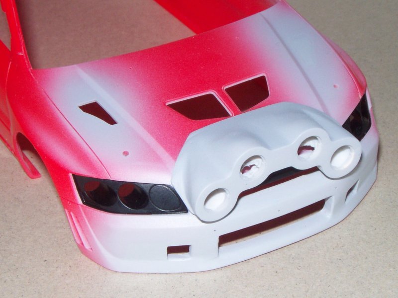

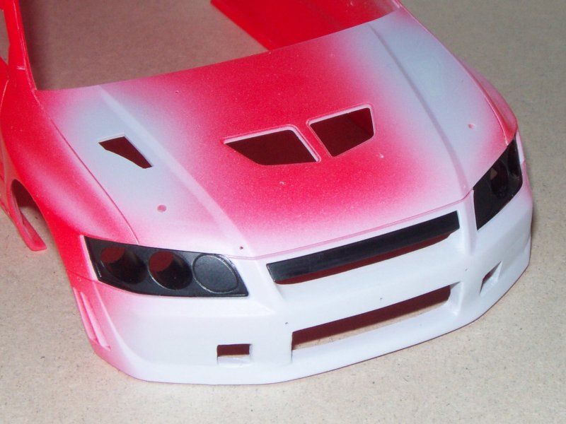

Been a week since the first update so here is my progress so far. Have removed all the parts off the sprues and am slowly filling in all the ejection marks and removing the mold lines. Most interesting area of work has been the nose modifications and the light pod.
Here is the nose after a quick primer coat of the modified areas. Still needs a lot of work smoothing down and shaping, particularly the two small inlets either side of the main intercooler opening.
Second shot shows the light pod after first primer coat. Still a lot of blending to do that the primer coat shows up. Was made from a Ford Focus light pod and a lot of putty. Not quite the right shape but reasonably close. Main fault is the two center lights are too far apart. Might have to slice the middle part out. Pod is attatched by two small metal pins.

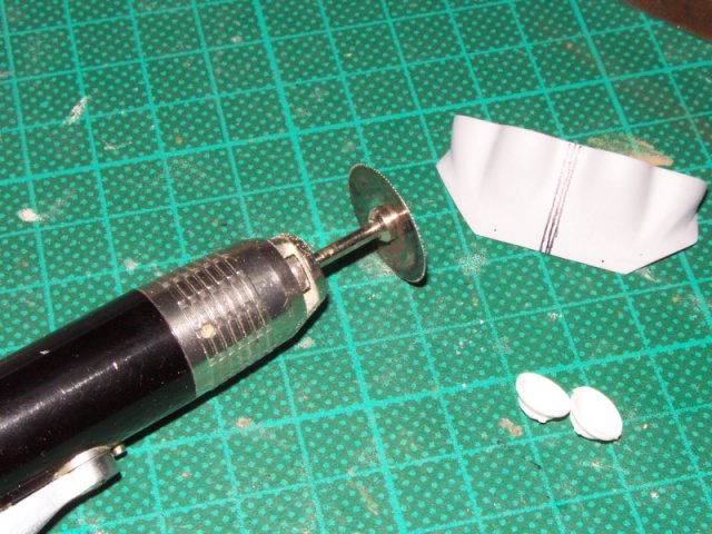

Went ahead and narrowed the light pod. Marked up about 3mm to be removed and sliced it up with this very dangerous looking attatchment.
This tool spins at up to 30,000 rpm and more melts than cuts through the plastic. The resultant cut is very rough.
I then cleaned up the edges and drilled locating holes for two metal pins. After that I joined the two pieces together with liquid plastic glue.
Next I had to change the contour on the bottom of light pod so it fitted snugly to the bonnet. This was achieved by covering the bonnet with plastic wrap. Then applying putty to the pod and locating on the car. When dry I'll remove the pod and clean up the edges. A lot of effort just so I can cover it with carbon fibre a bit further down the track

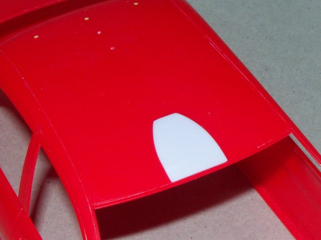

Another small mod needed was to replace the roof air scoop with a blanked off version. Not much need for cooling air in the Arctic! This was cut out of a piece of 0.5mm plastic card. Sounds simple but is quite fiddly to get just the right size.

The tool Phil has there looks to be a pneumatic rotary file, unless you have previous experience with one I don't recommend trying one on plastic, I have used them in the auto-tooling industry and they can easily make a mess.
Why don't you rather look into getting a Dremel electric rotary tool, it rotates at lower speeds but can do the same job, aside from the fact that you can select the speeds.

Everything is looking good on the Lancer and looks to be prgressing well, to be honest, I don't see anything wrong with the intakes, but I also don't have a variety of photos in front of me to compare it to
