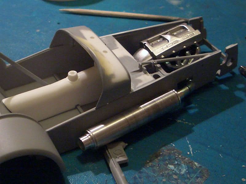

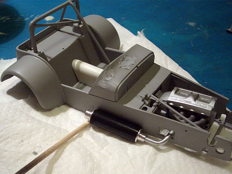

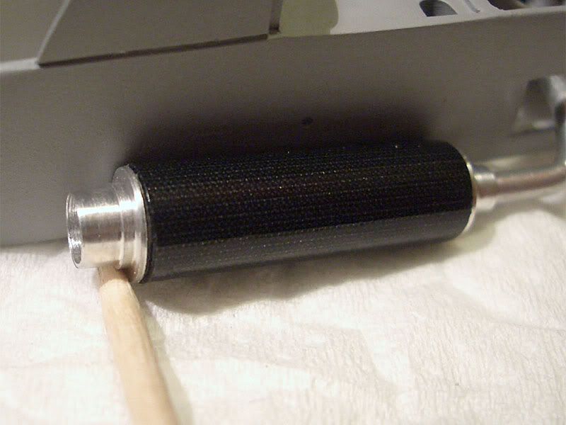

Thanks guys: few updates:
engine previously painted with Polished Alu (Alclad) was stripped and repainted MM Met Alu, buffed only the cam cover, sealed.
now it need some wire, fuel lines, cables, pulleyes and belts system with alternator and pumps in front, starter in back side.
Turned exaust: too long
cutted down, carbon decalled (HI-Res SM), I have to work on the manifold.
I worked also on the scratchbuilt air intake-ignition base (now a fuel rail is needed)
Soon with some engine details, next step finally on the body shell.

Wow, see what I miss when I skip town for a couple of weeks?
I love it with the Porsche inline 4!! Terrific engine for a 7. This will be another fun one to watch.

Once again, really nice work.
The exhaust looks fantastic!

Holy s***! Man I love what youve done with the exhaust! Is it scratchbuilt? That carbon fiber work is amazing too! Keep it up! Subscribed!

Fantastic works on the rollcage gio! And the exhaust pipe is amazing, I thought it's covered with real carbon fibre before seeing your description, that's perfect! Can't wait for more!

It's awesome!! Ultra cool! I love the way the exaust looks!!!

Geo, How big is your new muffler?
I'm going to make one as well and I'm trying to save any time I can.
SCCA 7, The lost Z
  #30
Old 03-01-2007, 03:47 AM
gionc's Avatar
gionc gionc is offline
Authorized Vendor
Join Date: Oct 2005
Posts: 3,911
Thanked 47 Times in 41 Posts
Re: AFS7 Group Build, gio's contribution ;)
Ferrari TR: approx 22 mm long diam 0.75 mm, I guess mine is a bit undersized but I had to cut, simply I unliked bigger.

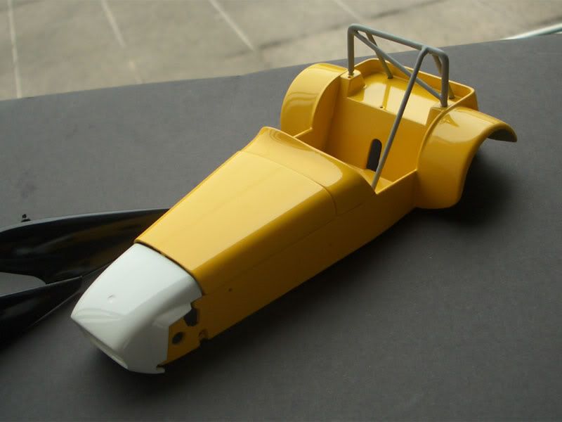

Updatez: finally after dozen pass of primer-putty-primer-sand etc. I had a decent grey surface, sanded with 2000 grit, followed by white primer (sanded+polished under runny water), than I sprayed stright from the can the Bright Orange (a couple of mist coats) followed by 3 coats of yellow (TS16? ever straight from the can). Now I have to wait for curing an so polish it. Next steps carbon on fenders and clearcoat (not sure may be only matt clear on fenders, I like the thiny appeal of yellow w/out clear). Nosecone would be carbonized, except the front white line. Primers wasn't sanded and polished in the interior's panel so I'll see a different texture, polished out, rough inside . Last edit: I just LOVE multilayer painting with different colors, I start to se this tip with my 360CS, now I have a reach yellow that on reflection allow to see something of the orange
