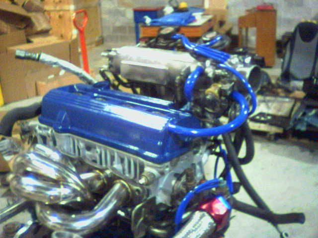

yeah honestly I've heard very few bad reviews about the megasquirt. Yeah it doesn't look pretty but who cares what it looks like, also I'm not quite an engine expert yet even though a simple rebuild isn't all that hard. The whole point of this project is because I believe very strongly in the 5s block, and would like to see a kit made for it. One thing I do know though is electronics, and you basically have a microprocessor controlling that engine, really the design of that board in the megasquirt is pretty simple, the problems people are having aren't in the ecu as much as they are in the programming and the tuning. anyways heres the build so far

is that an xs power turbo manifold? if so watch out, it could break at anytime.

yeah it is. Yeah I'm kind of bettin its not gonna hold up, its ok if it doesn't I've got the stock one here I got for like $20 so if it does break I'll just swap em out, but hey if it holds up then great.

you know what happens if it dosent hold up? your turbo is one the highway while u keep driving down the road....lol
if you have a brace for that DP it might live but taht manfiold is SHIT
