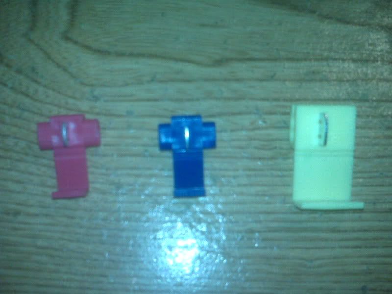

Well I'm feeling bored and ambitious so looking to get started on the WBO2. I want to use the guage as well as connect it to Link. I understand that I need to wire up to pin 15 but what do I do when it comes to connecting the wires physically? Do I use these
and just simply tap in?

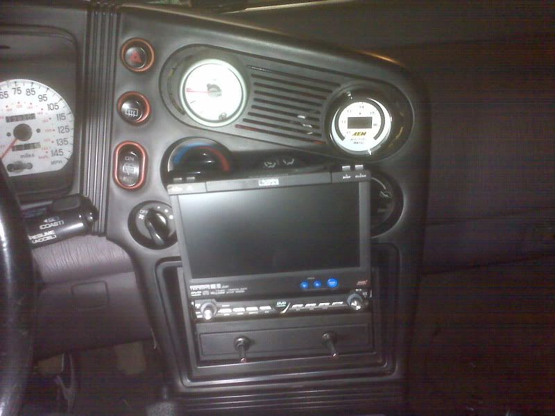

Almost installed here's it mounted and mostly wired.

Dont just tap into the wire, you want to cut it and then solder the WB to the ECU. I think we have looked into this before and pin 15 doesn't do anything stock but you should still cut it just to keep interference down etc.

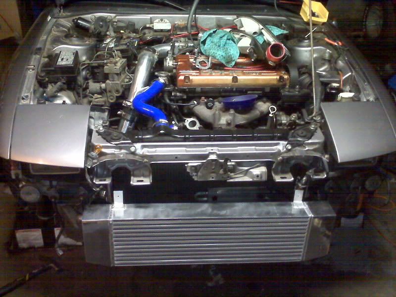

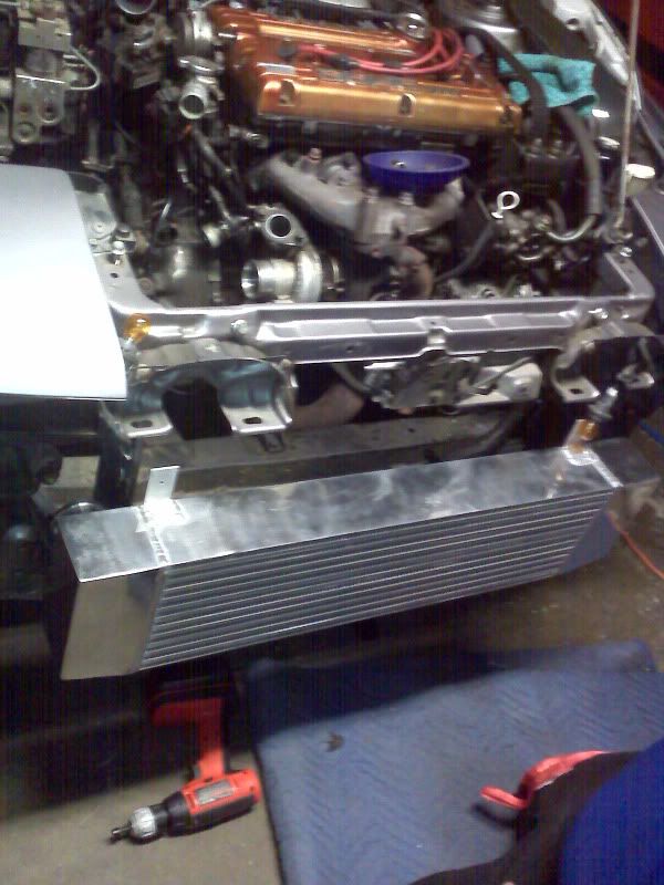

Wheres the FMIC pic?? Parts look good ned.
If I were you I would just directly hook up the WB to the ECU first and test out its operation. You aren't driving the car right now so pull the WB sensor out the exhaust and hold a lighter to the tip of the sensor. Dont light it just let the gas hit the sensor and it will bottom out the wb. If it doesn't read past 11.5 then just build that circuit. Its a super easy circuit man. Probably cost 5$ in parts.

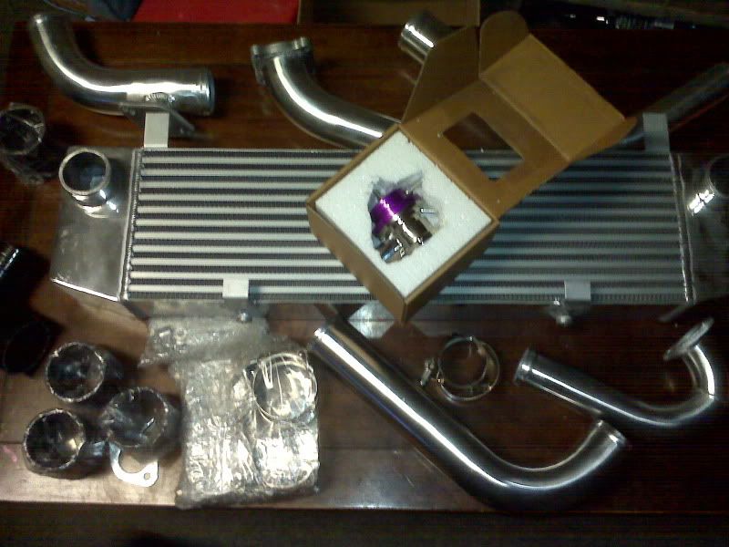

Here's a couple pics for the hungry folk, didn't know it came with a knock of bov either...anyone need a bov?

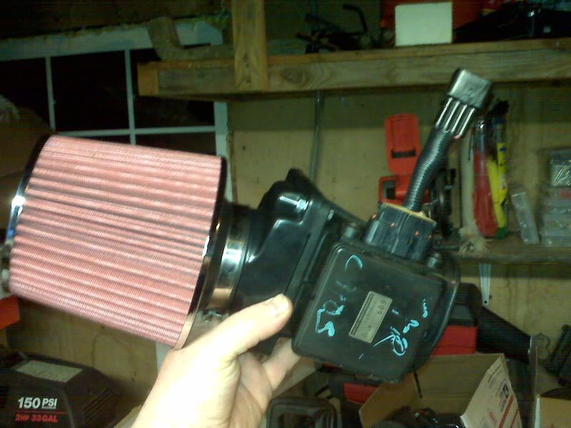

Starting to reconsider the 2g MAF setup, just doesn't fit right/at all. I have everything I need but can't get it to fit. Lando, any suggestions? Probably with a much shorter filter or a thinner adapter with a shorter filter. Any suggestions? I'm talking like I need at least 2 inches to fit.
Another pic
