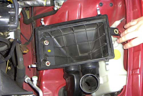

Old 05-24-2003, 01:00 PM
mynismo mynismo is offline
yada yada yada
Join Date: Apr 2003
Posts: 2,928
Send a message via AIM to mynismo
here's a pic... somewhat
take out the bottom part that goes underneath the car. you could take out everything underneath the air box.
