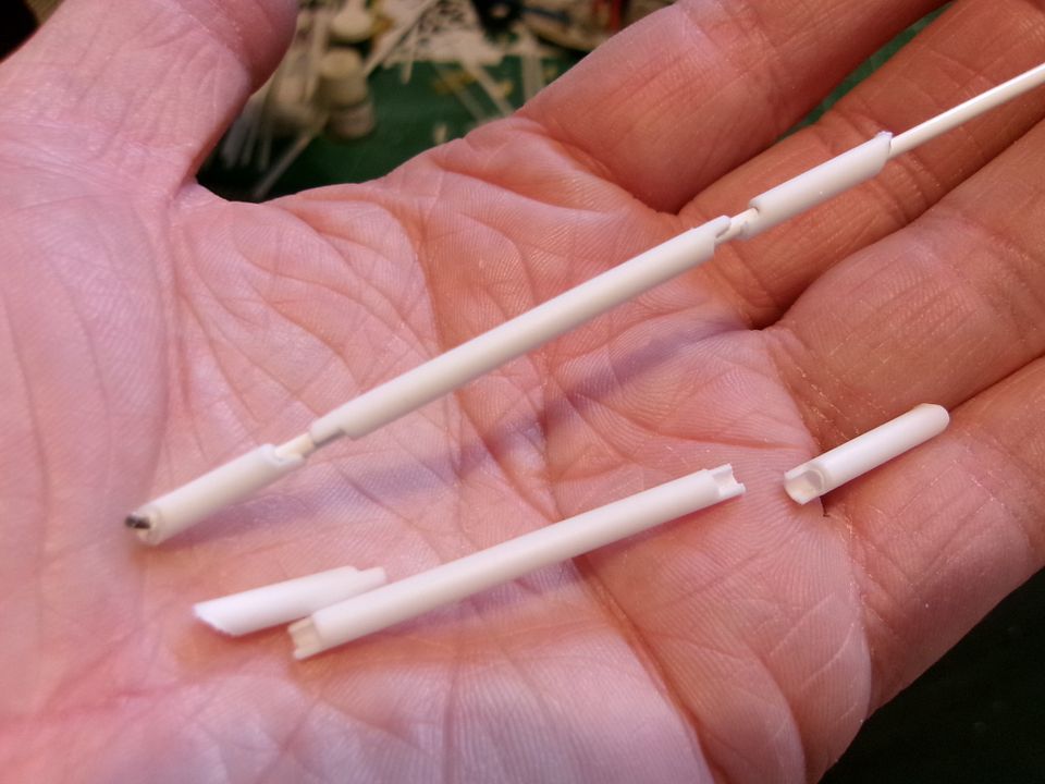

All the styrene tube here is 3.9mm (5/32”). Every tube has a length of ali tube inside, pinned at both ends and CA’d together. There’s more diagonals and bits of detailing to be added in the engine bay, but once these three layers of tubes are in place that’s the key structure. Here’s the upper layer in progress:
In time there’ll be two connections between the two sides of this rear hoop – one removable crosstube, and a fixed framework that will extend from the back of the hoop. In addition, there’s a lot of platework to be grafted into this areas to reinforce the tubing, and to provide the upper damper mounts and gearbox mounts. At the front of the engine bay there’ll be fabricated pick-ups for the upper and lower radius rods, all of which will tie-in with the new tubes attaching to the back of the cockpit section. When it’s all in place there’ll be plenty of greenstuff added to fill the gaps and create the usual welding detail

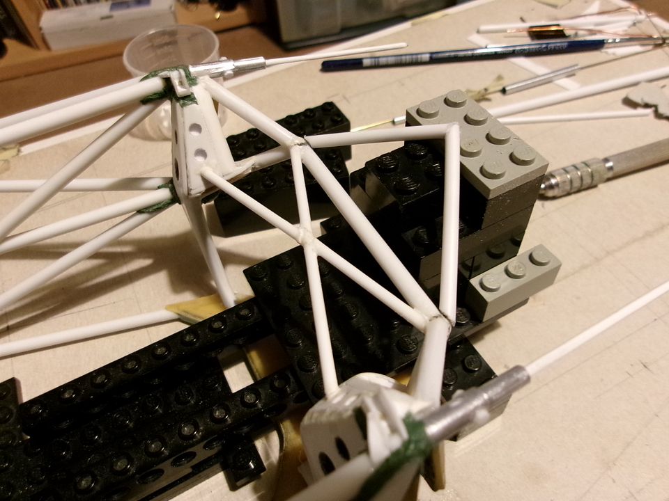

Having got this far, I decided it was the right time to complete the frame by making the tail support extension; this has been my focus for the last couple of weeks. This extension adds about 7” in length to the main 16”, and given how it is attached and the weight it will have to support I decided to use aluminium tubing rather than styrene. Most of the main tubes in following photos are 5/32” (which allows me to put 1/8” styrene tube inside for pinning), but there’s also some 1/8” for the smaller tubes.
First job was to create a jig structure from Lego which would extend beyond the rear suspension and keep everything square to the back of the cockpit:
The lower frame pins into the suspension underframe structure, and the jig allowed me to get the top tubes positioned correctly before adding the two little stubs to the main frame. The long pieces of styrene-coated wire will extend into the 1/8” styrene tube inside the ali top tubes, giving me plenty of options for gluing it all together.
Once I’d got the top and bottom frames reinforced, the next job was to start drilling them to add a couple of vertical tubes. You can see below where I’ve inserted lengths of 1mm rod into the main tubes, and also some more coated wire into the bottom tubes which will anchor the diagonals:

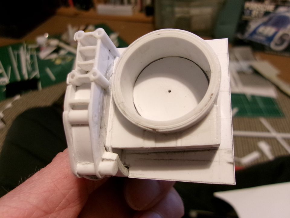

To start with I’m only working on the gearbox main case – the gear cluster section isn’t structural or used to mount anything (unlike the 956), so I’ll add this later. The core of the main case is a hoop element, combined with a 1mm thick centre ‘spine’ plate as the starting point for the diff housing:

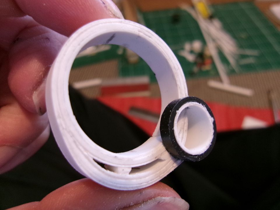

The cross-section of the bellhousing is not a perfect circle, so I grafted an extension onto the underside. The hoops are layered-up from 0.4mm and 0.5mm styrene strips, glued around a former. The smaller black section of tube will be the mounting for the starter motor.

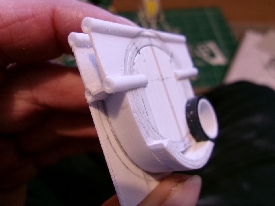

The bellhousing hoop was glued to a 0.75mm plate, and the inner core made from box-section to allow the diff-housing plate to slot into it. 1/8” tubes were added across the top of the bellhousing and are pinned for strength, as they will be used for the mountings to the chassis frame.

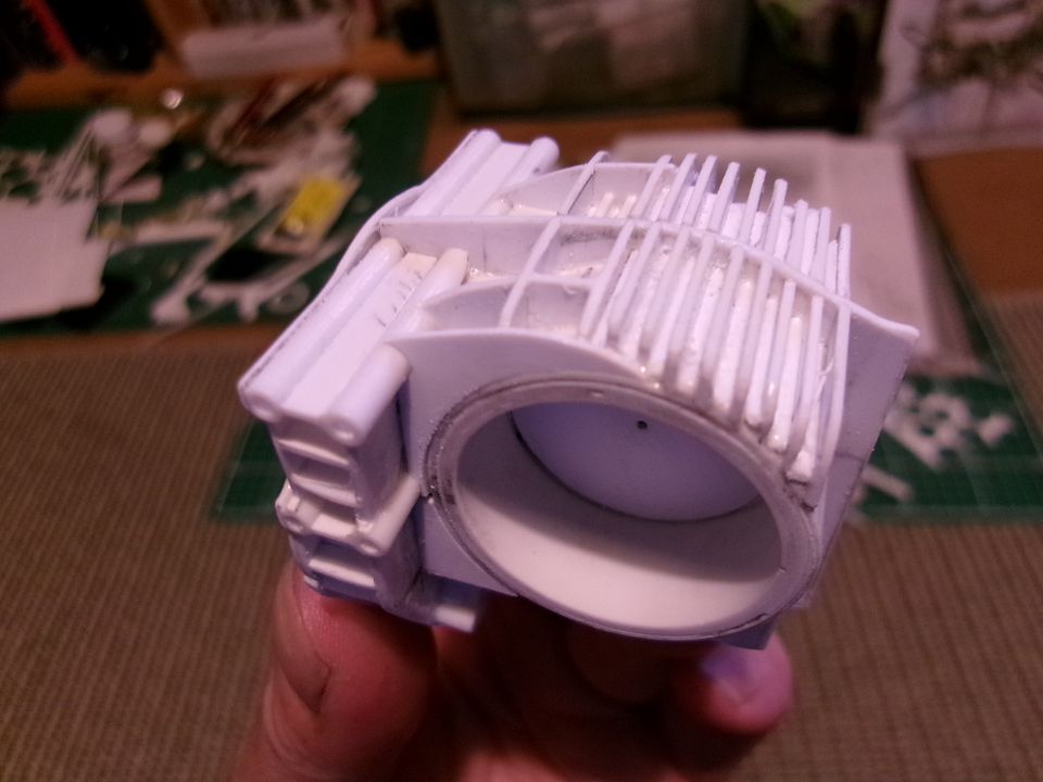

Various pieces of webbing were added to the bellhousing section, and the core of the diff housing was put together from box-section (right-hand side) and another layered hoop (left-hand side):
From here it’s a slow process of creating the shapes and building up the detail. I started with the right-hand side as the webbing here will cross-over to the left-side (and I have better photos of this side!). The main webs are typically 0.75mm
