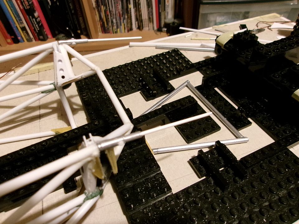

By the start of February I was ready to extend the chassis into the engine bay. As usual, Lego was used to create jigs and supports, and to help keep everything square and true. The lower frame is hidden in this next photo, but in time this will have an extension added which will provide the pick-ups for the lower parallel suspension links, and support the gearbox:
All the styrene tube here is 3.9mm (5/32”). Every tube has a length of ali tube inside, pinned at both ends and CA’d together. There’s more diagonals and bits of detailing to be added in the engine bay, but once these three layers of tubes are in place that’s the key structure. Here’s the upper layer in progress:
In time there’ll be two connections between the two sides of this rear hoop – one removable crosstube, and a fixed framework that will extend from the back of the hoop. In addition, there’s a lot of platework to be grafted into this areas to reinforce the tubing, and to provide the upper damper mounts and gearbox mounts. At the front of the engine bay there’ll be fabricated pick-ups for the upper and lower radius rods, all of which will tie-in with the new tubes attaching to the back of the cockpit section. When it’s all in place there’ll be plenty of greenstuff added to fill the gaps and create the usual welding detail
At this stage the similarities with the older 908 and 917 chassis are increasingly obvious. It’s worth noting that at this point the chassis frame measures about 380mm long – there’s still the tail-support frame to be added, and that will put another 190mm onto the length…!

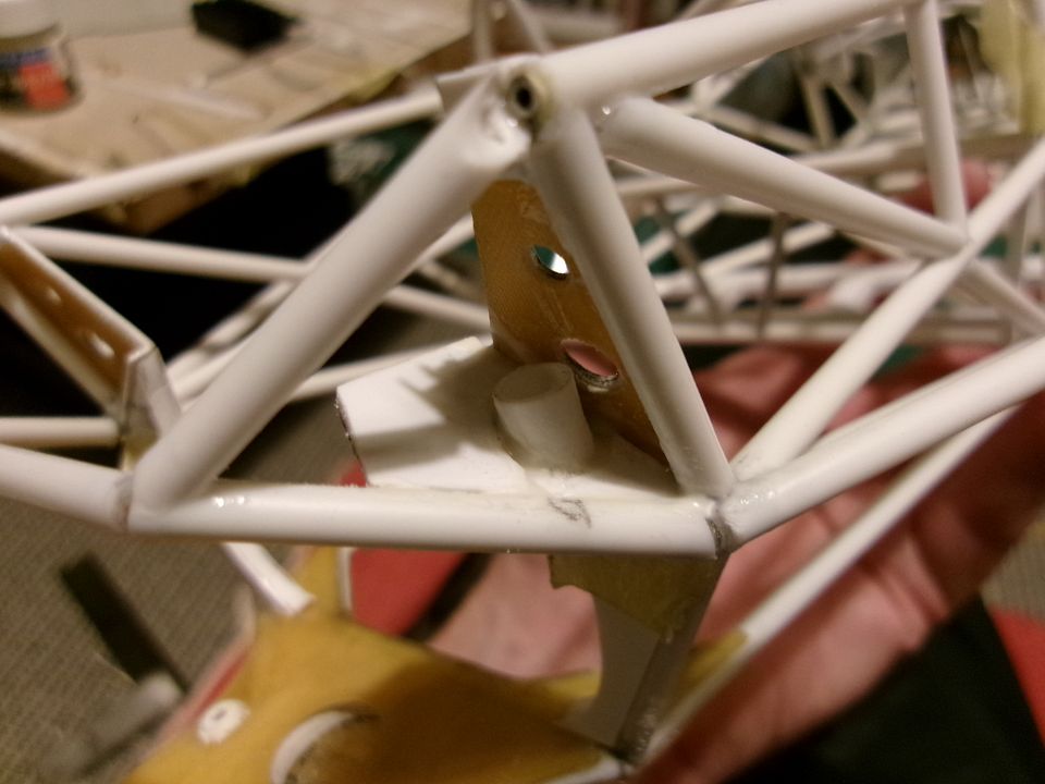

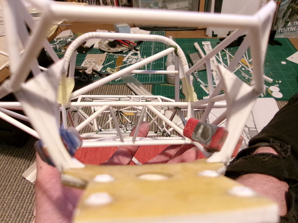

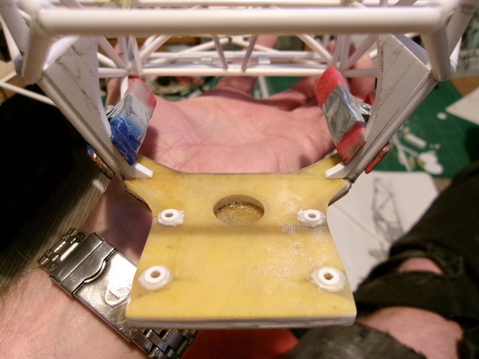

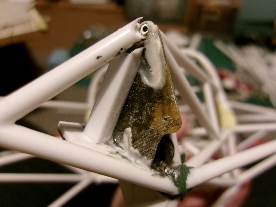

Starting at the bottom, the extension for the suspension mountings is based on a core of ¼” x 1/8” box-section, pinned into the back of the lower frame tube. Extra box-section is added to the sides to create the cut-outs for the four links to fit into, and then the whole lot is sandwiched between two pieces of fibreglass sheet. The holes for the links are reinforced with small styrene washers, and in time there’ll be greenstuff applied around the edges. The rear edge is a solid beam, as it will eventually be where the lower tubes from the tail support frame attach.
In these photos you can also see the upper tubular frame taking shape - this ties together the two sides of the engine bay and forms a base for the damper mountings. You’ll notice that where the uppermost tubes meet the main frame they’ve been cut away to allow another tube to be added later – again, the tail support frame will be connecting here and will pin directly into the top tubes.

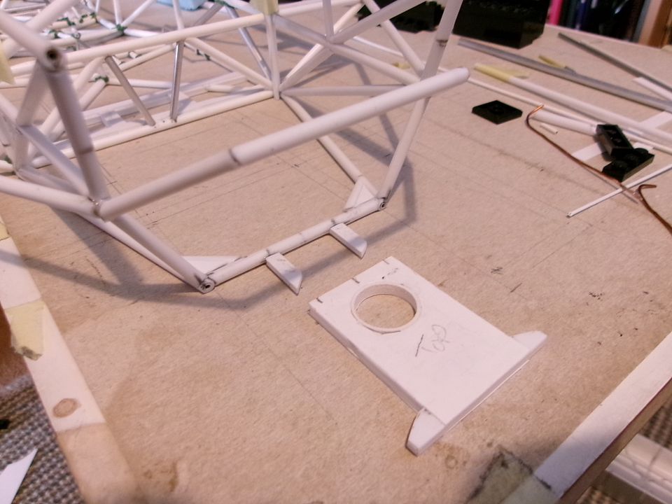

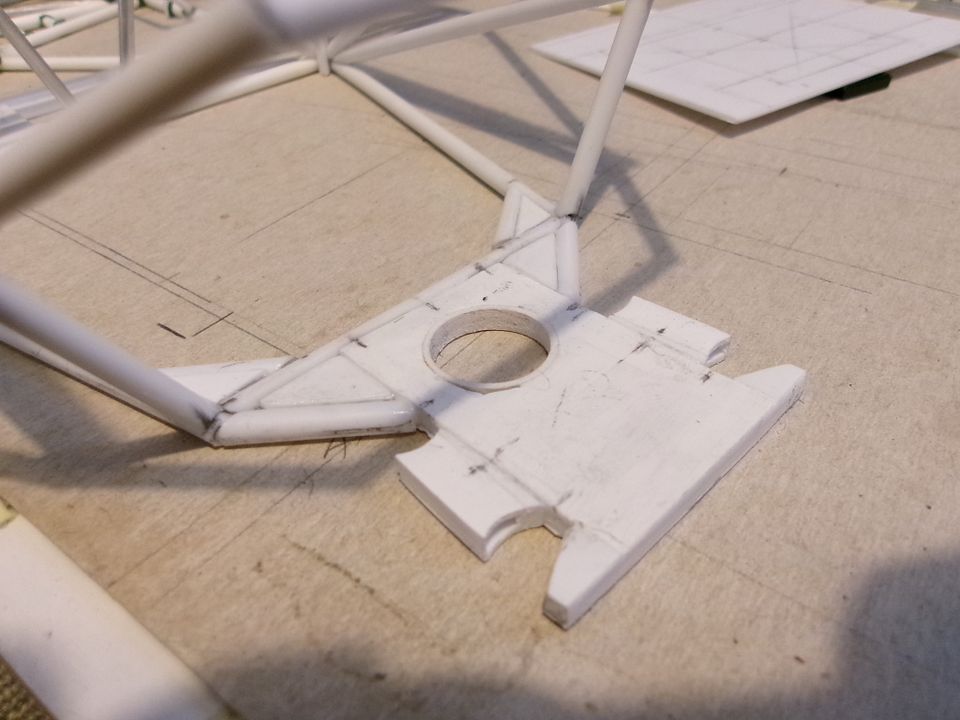

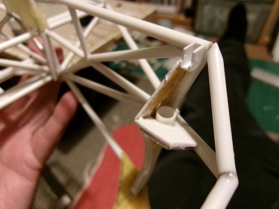

The next stage was to reinforce the lower vertical tubes – I made two crescent-shaped extension pieces from solid styrene stacked together, glued these to the vertical tubes, then added plates front and rear. I expect these will need some shaping and adjustment somewhere down the line.
Above these I’ve started adding the platework which will support the damper mountings. This is where things have slowed down a bit, as nothing is ‘regular’ – everything is positioned at an angle, or locking into other plates. It’s not impossible to work out, it’s just time-consuming. There’s also a couple of tubes buried into this structure – these will be where the side-mounts for the gearbox attach.

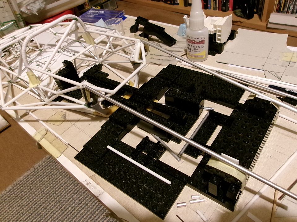

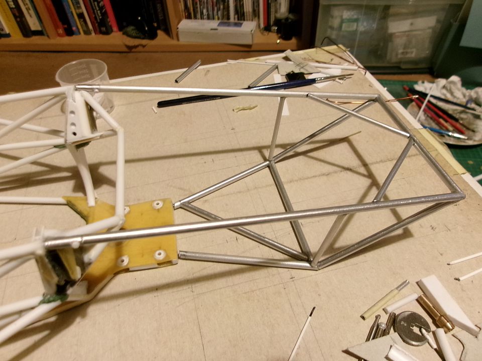

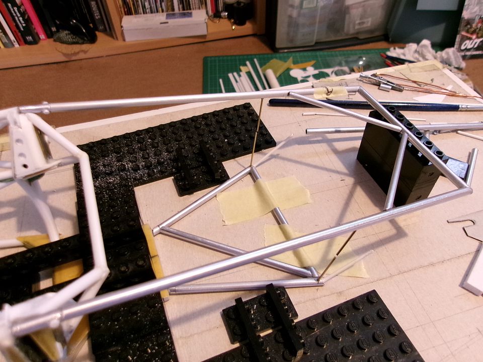

Having got this far, I decided it was the right time to complete the frame by making the tail support extension; this has been my focus for the last couple of weeks. This extension adds about 7” in length to the main 16”, and given how it is attached and the weight it will have to support I decided to use aluminium tubing rather than styrene. Most of the main tubes in following photos are 5/32” (which allows me to put 1/8” styrene tube inside for pinning), but there’s also some 1/8” for the smaller tubes.
First job was to create a jig structure from Lego which would extend beyond the rear suspension and keep everything square to the back of the cockpit:
The lower frame pins into the suspension underframe structure, and the jig allowed me to get the top tubes positioned correctly before adding the two little stubs to the main frame. The long pieces of styrene-coated wire will extend into the 1/8” styrene tube inside the ali top tubes, giving me plenty of options for gluing it all together.
Once I’d got the top and bottom frames reinforced, the next job was to start drilling them to add a couple of vertical tubes. You can see below where I’ve inserted lengths of 1mm rod into the main tubes, and also some more coated wire into the bottom tubes which will anchor the diagonals:

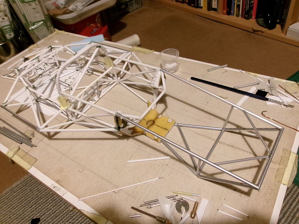

So, as of today, April 8th, here’s what the chassis frame looks like:
It’s just under 23” from tip to tail – that’s about 3” longer than the 935-78 frame, and basically the same length as the completed 956, less the tail overhang! The extension is not complete – there are some extra diagonals to go in and some more tubes to add over the top of the gearbox, plus all the joints will need some greenstuff detailing. There’s also some small brackets to add and the mountings for the turbo ducting, but that’s all work for another day. Fortunately, the extension will be left removable so I can put it to one side while working on the main chassis – I don’t want to start damaging it while the model is still in-build!
What’s next? I’ll continue with the tail extension frame, and the extra tubing over the gearbox. After that I’ll probably start looking at some of the mounting brackets for the rear suspension on the rear bulkhead, and just adding details here and there. There’s enough work to do on the frame to keep me busy for several months, so I’ll probably aim to see what I can get done by the end of April, then spend some time working on something else...
