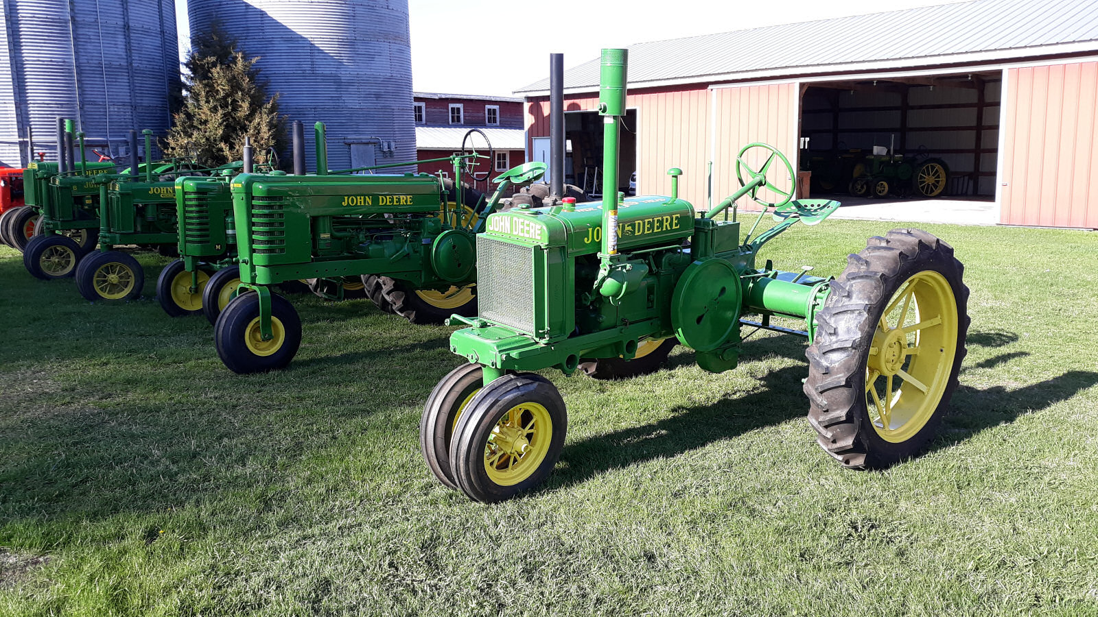

I recently recovered a stash of antique tractors, designed to run on gasoline and/or kerosene. Every one of them was operated on modern, unleaded, ethanol-blended fuel. Of course, I added about 2% 2-cycle oil to the fuel for valve and upper cylinder lubrication, and had no problems whatsoever. I tend to do that with all my older engines.
