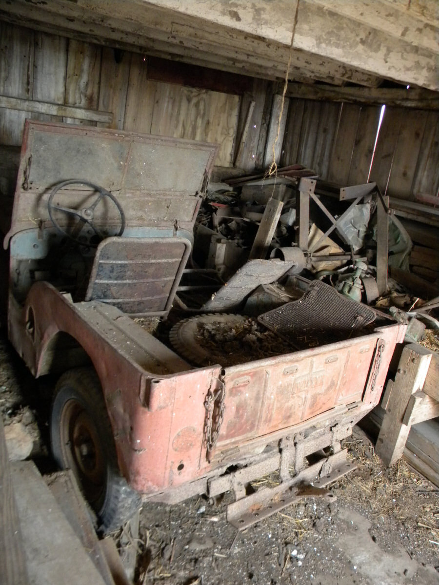

I'll be doing the same thing on this barn-stored version, also a '48, very soon. It runs on starter fluid manually fed through the air horn but the inlet needle won't accept fuel. Hopefully I have better luck.
