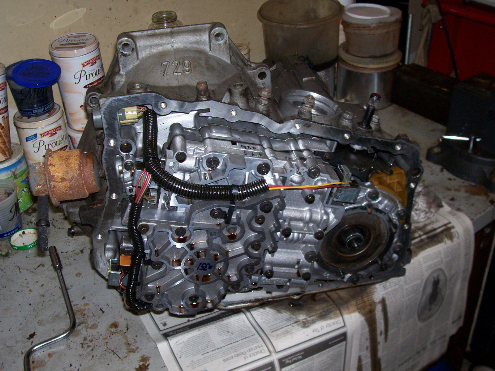

Can anybody tell me where the electrical connector for the shift solenoids is located on the outside of the transaxle?

Follow the wiring harness and you will see the external connector right above the vacuum modulator.

Thanks for the picture Blue Bowtie.
6 wires in that transmission harness; brown, white, green, black, yellow, red.
Red goes to three solenoids that I can see. Would that make red a 12V supply, and the other colors the designated grounds from the PCM?
I see yellow, black, and green going to 3 solenoids.
What do the brown and white control?
I will search for a schematic in the service manual.
If I jumper A and B terminals on the diagnostic socket with the key on will I be able to check all of the grounds at the round connector above the modulator? I think I saw that in the manual?
Is it absolutely necessary to undo a frame member and lower the transaxle to remove the side cover? I would want to remove the minimal amount of stuff to get at those solenoids. If I have to change one solenoid I would like to change them all while I'm in there?
