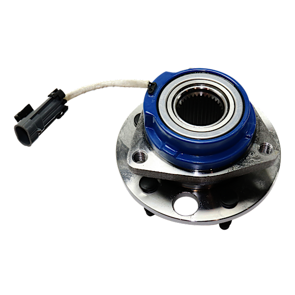

Took the car to the garage this morning. Analyzer identified a magnetic strip fell of the left rear wheel. They said it needs a new hub assembly. Magnetic strip???

On the 2014 Impala the wheel sensor is molded to the end of the wires. The sensor is
then bolted to the hub assy. No handy connector to do troubleshooting. Other than that the wires are neatly layed out with no sharp bends or apparent damage.

The garage removed the bearing assy and replaced. Around the inside surface of the bearing assy is a magnetic strip. Part of the strip was gone causing all the excitement. The wheel The bearing was ok. only problem was the mag strip. The mag strip is providing the input to the wheel sensor.
