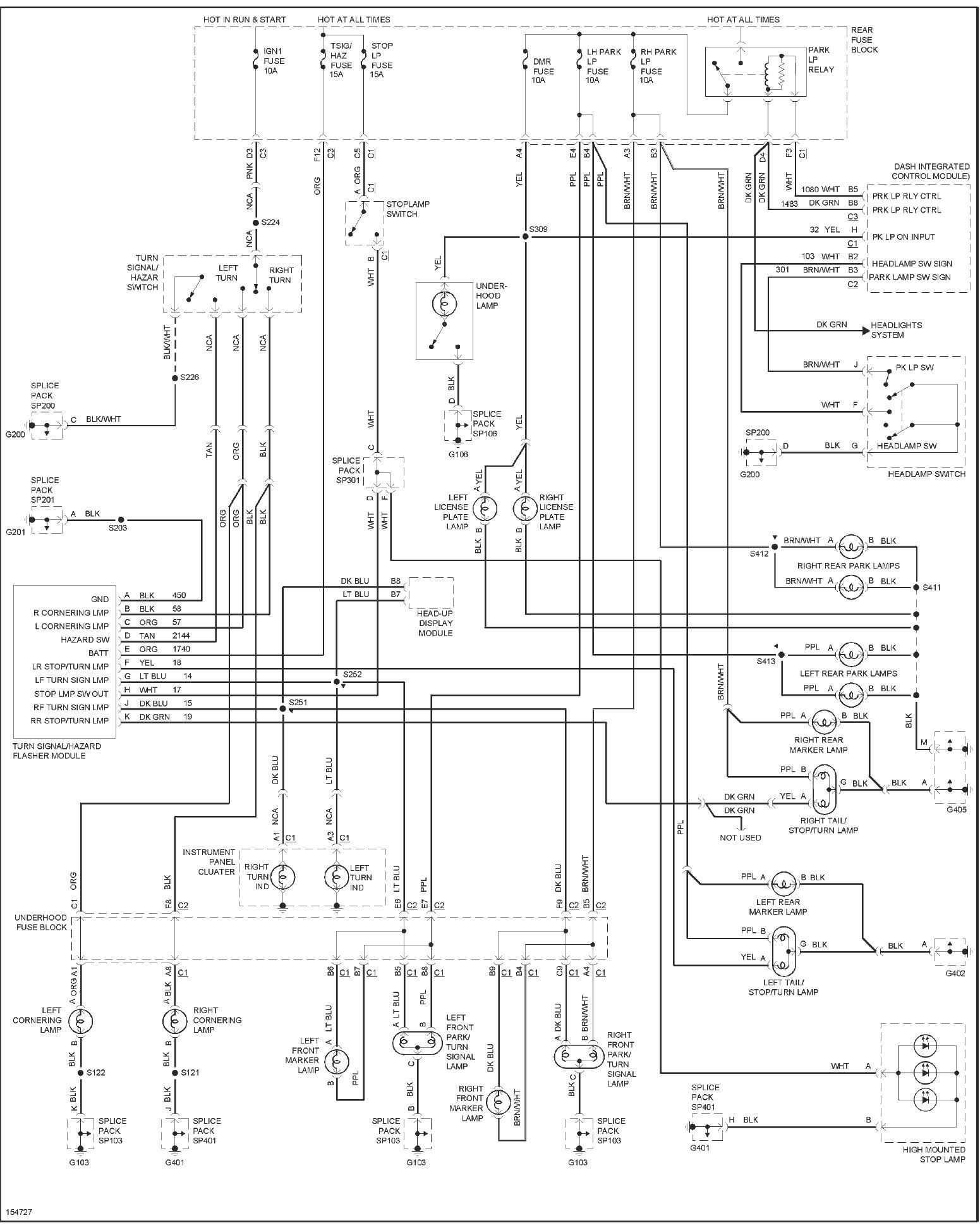

Do the signal lamps operate normally if the four-way hazard flasher is used? It may be useful to exercise the four-way switch a few cycles just to be sure the contacts are clean and completing the circuits.
The second most suspect item is a malfunctioning turn signal (multifunction) switch. Of course, all lamps must be intact and properly grounded for the system to function normally.

I would be suspicious of grounding in at least one lamp circuit. If one of the front turn or side marker lamps is not properly grounded the power may be feeding back through the headlight filament to the rest of the running/marker lamps.
It might be easiest to remove one lamp at a time, starting at the front, and see if the phenomenon continues.
