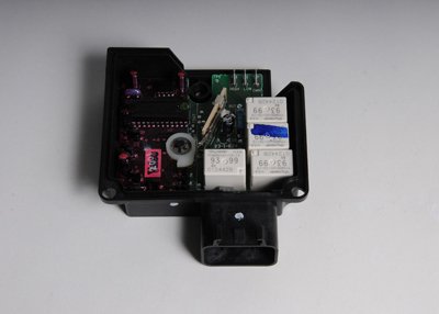

The control/pulse board on the motor may have an issue (P/N 12487675). It's at least worth inspecting the connections, both into and out of the unit.
