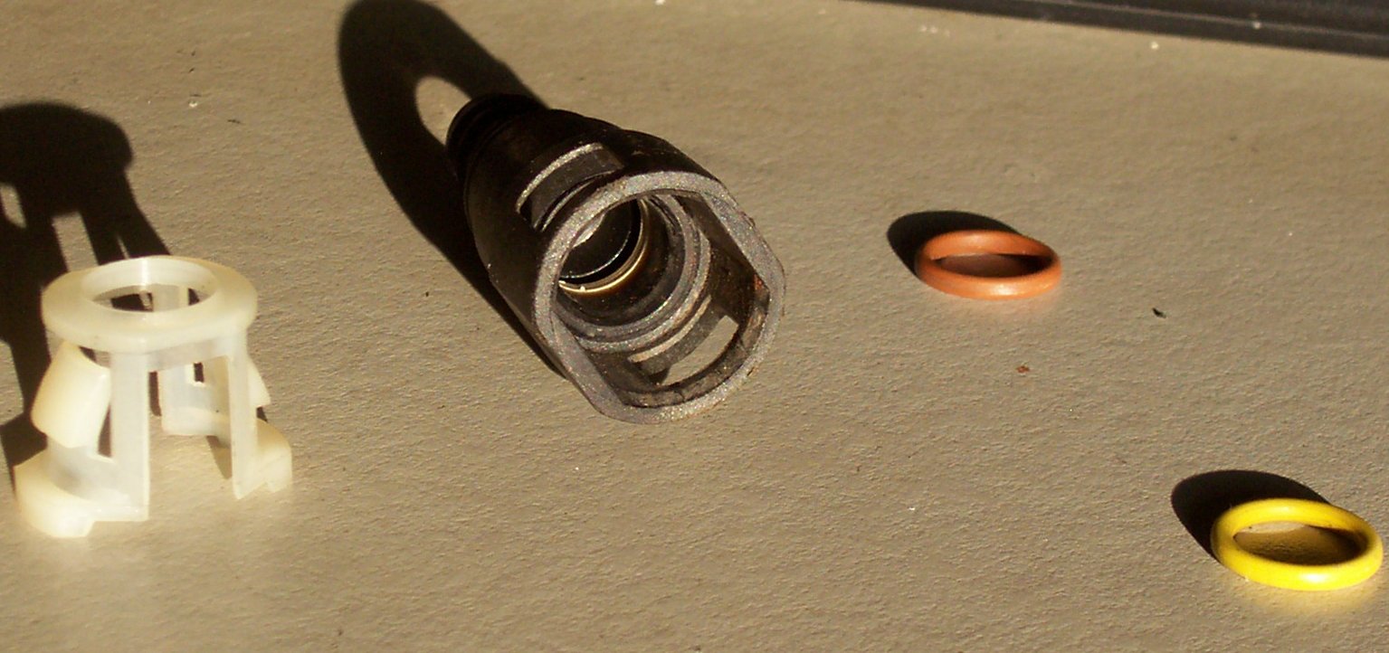

Anyway, in the process of flailing under the van when the gas hit his face, he jumbled up these little black and rainbow colored rings and lost a long rusty screw/bolt that screws the main round body of the fuel filter to the underneath of the car and holds it in place.
We searched and could not find the bolt. My husband jumbled up the small rubber rings and did not know what was from the old or new filter. He tried placing them on the new fuel filter but as soon as he turned on the car, not even the engine just turned the key to where you can play the radio... all this gas sprayed out from the new fuel filter. After many tries of re-arranging the little o rings he gave up and called a tow truck.
Today he called auto zone and they looked at a new fuel filter in it's box (same one my husband bought) and told my husband that there was only one small black o ring on the fuel filter. So he put one ring on his new fuel filter (on the male hose I think) but still the filter sprays gas as soon as he turns the key. He then went and bought new 'hose clips' and tried those. The fuel filter still sprayed gas.
So, what I am now trying to find out is what could possibly be causing the fuel filter to spray the gas (leak). My husband (in his words) is a welder, not a modern car mechanic and is getting really stressed over this. I was hoping maybe someone had some tips or ideas for us to check on to fix this problem.

The filter uses barbed plastic clips to hold the line fittings to filter. There is a male fitting on the inlet end and female fitting on the outlet end.
The end of each line is sealed by an O-ring. If the O-ring is damaged or missing the connection will leak. The O-ring is installed on the male end of each line connection. Only ONE should be used on each end.

Husband: The female end (of the filter) has 4 inserts (2 o rings, 2 flat rings) and does not leak. The female end (of the gas line) is the end that leaks. I have tried multiple combinations with the leftover rings and nothing has worked. I have tried a single o ring also with no success. I went to the store and bought a second filter in case the first was damaged and it still leaked. Could I have damaged the hose? --Thank you.

Technically, you are correct about the seals, but they should NOT come out without intentionally picking them out.
The deepest is an FKM (Viton) O-ring followed by a PE guide ring, followed by a silicone O-ring, and finally a UHMW (Nylon) sleeve/bushing/clip nearest the fitting opening. If these are damaged, the potential for leaks exist. The steel standpipe which slides into the fitting must also be clean, free of rust, not distorted, and it helps to apply a bit of clean engine oil to aid in insertion. The oil will not negatively affect any of the materials.
If the connections are not clean, sound, and smooth, there is little chance of them sealing. The hose fitting can be replaced, but it requires special procedures including warming the hard nylon hose to a controlled temperature, supporting the hose in a round clamp (like a flare tool line clamp) to prevent kinking, then inserting the new barbed fitting straight and quickly. Of course, there must be enough line length available to accomplish this and still connect the filter.

There should be no o-rings on the filter itself....if two plastic lines attach, the o-rings are in the lines.......
