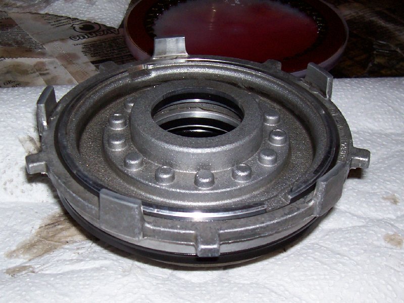

Losing 3rd and 4th would be related to the direct (forward) clutch and associated parts, such as the forward sprag. Losing 1st without losing reverse could be a valving issue and not a hardware issue, and as j CAT indicates, a scan might be helpful. It could also be a low input clutch or apply piston, or the associated mainshaft seals for that apply piston:
