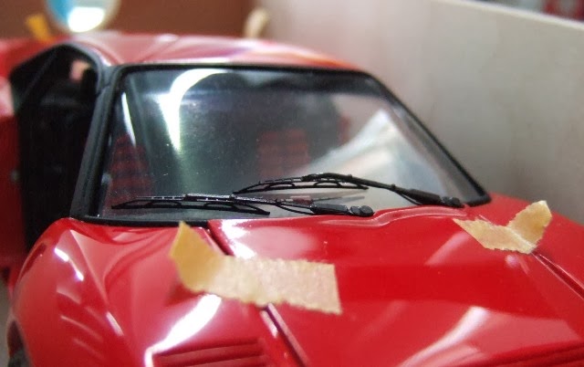

The clacks of left door were filled up with "the body color and clear mixed paint" then clear coated and polished out.
The window glasses were from 0.3mm plastic boards.
Trims were also 0.3mm plastic boards.
Revells wipers were thinned out and 0.3mm plastic strings were adhered as washer pipes. Blades were from Fujimi's PE.

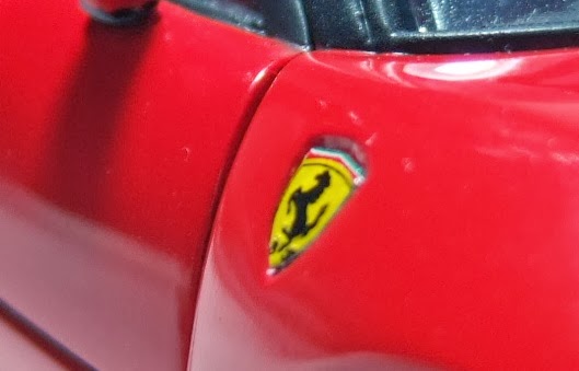

PE + decal emblems were finally attached.
YES!!!!! Finally, finally, all my hard works were rewarded!!!
Pininfarina's emblem were from Hobby Design.

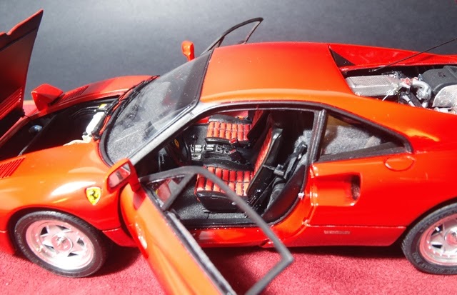

Expression of dash using flocking powder is a bit too exaggerated, but for me it's fine
These photos were just quick ones. I'll upload better photos on the gallery soon (Edit: uploaded on 10th Nov,13).
The base was Wave's T-Case and wine-red cloth, trimmed by wooden sticks. Name plate were from Hobby Design.

Prancing horse inlet mark was painted in smoke (rear).
Can you see the tiny small Ferrari logo on gear box?
The muffler cutter were from aluminum pipes.
I like this height.
