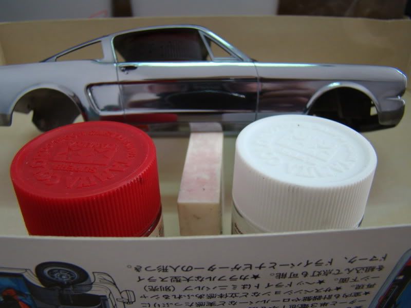

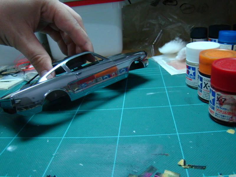

I did this test 2 years ago....
Automotive Gloss Black
with Kosutte
Problem with Kosutte is that the fingerprint marks the paint.
First test: I put my finger 100 times in the trunk lid. Result: it loses the gloss and looks like aluminum.
Second test: I used a polisher in the roof. Result: Kosutte is gone.
Third test: after a few days, more kosutte and microfiber cloth to clean the body. Result: more shine!
It's been 2 years since these tests and the body remains exactly the same way, no shine was lost. I still want to apply the clear coat to check the result.

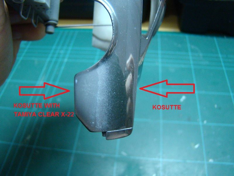

I know Pacheco, I'm using this body to do some paint tests.
And I did it this morning...
Unfortunately the clear paints I have here don't work well with Kosutte.

Try Alclad's Aqueos clear cote. It was made to cover the chrome. It works very well without reducing the chrome effect. Also try Future. The problem with other clears is they react with chrome paint or Kosutte coating. These clears are very neutral chemically and do not react.
