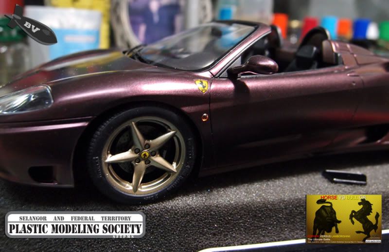

Original rims and custom Pale Gold Rims

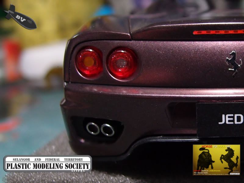

I found that the pearl red on black looks pinkish, so I added some metallic red to the pearl mixture and spray another layer
Although the outcome isn't the actual color in my mind but it turn out being a stunning color that I decided to maintain it.
The main technique of spraying pearl coat is a thin 2:8 paint:thinner ratio + 10% of clear. After finish, I felt that I should keep it matt, this so far the best matt color I've ever spray.

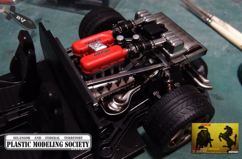

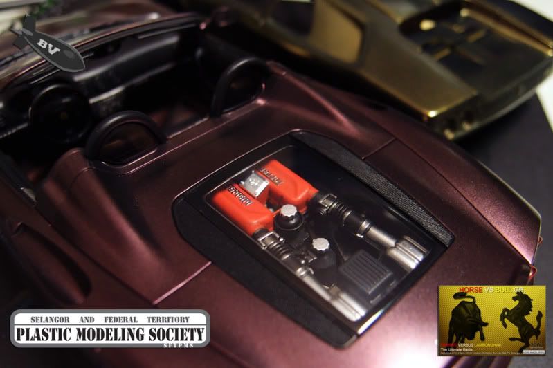

Hand-brush the throttle body with red (acrylic)

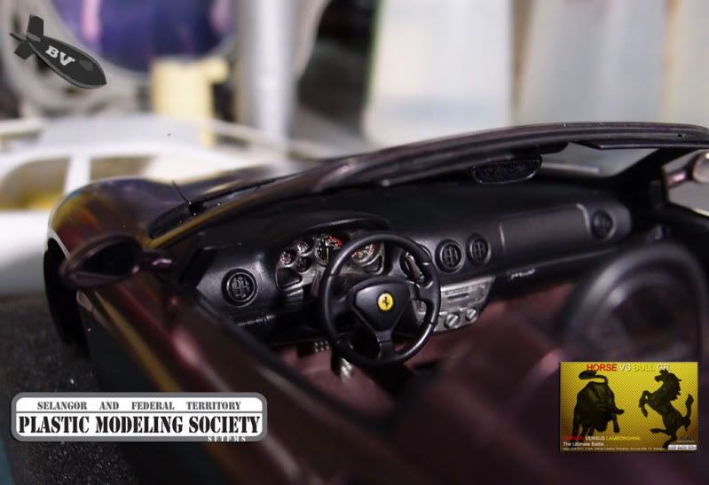

ok, finally completed the engine compartment, nothing extra, just purely OOB.

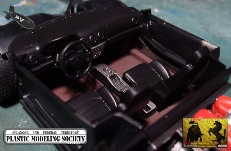

Interior done

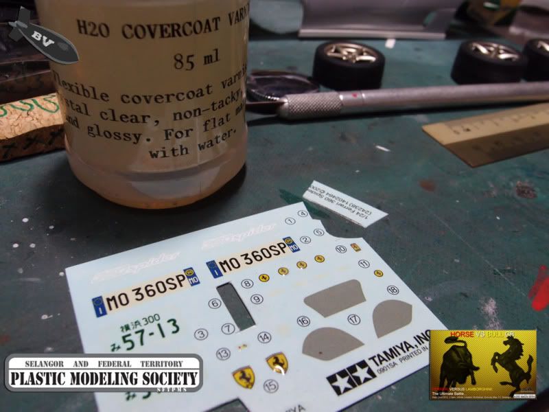

the emblems on Ferrari are stick-on type, so I'm trying to convert decals to stickers. First by using H20 overcoat to brush on the decals, creating a bulge.

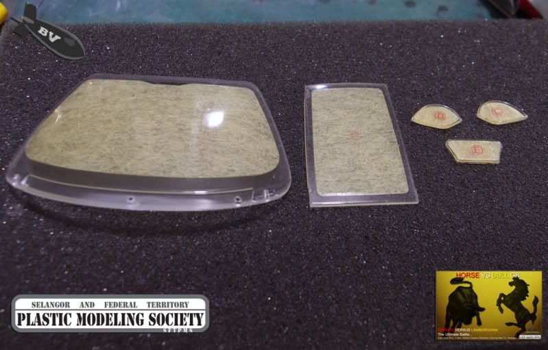

believe or not, this is the first time I use kit-provided masking tape, it's much more easy compared with doing it your own. I apply some soapy water on the clear parts before sticking the masking tapes on it so that I can still adjust the mask after applying.

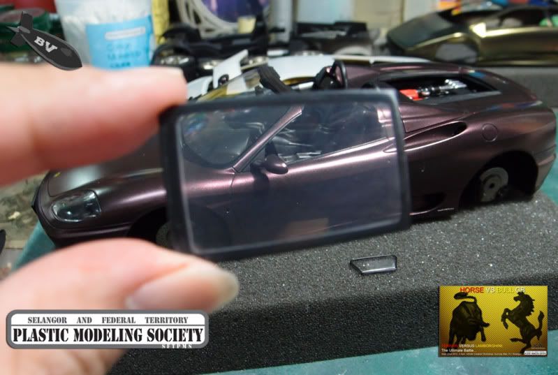

Disaster!! extra thin cement flow to clear parts.... what can I do? need help here.
This is the only con on this "almost perfect kit", there's sink holes on four corners of the rear clear parts.

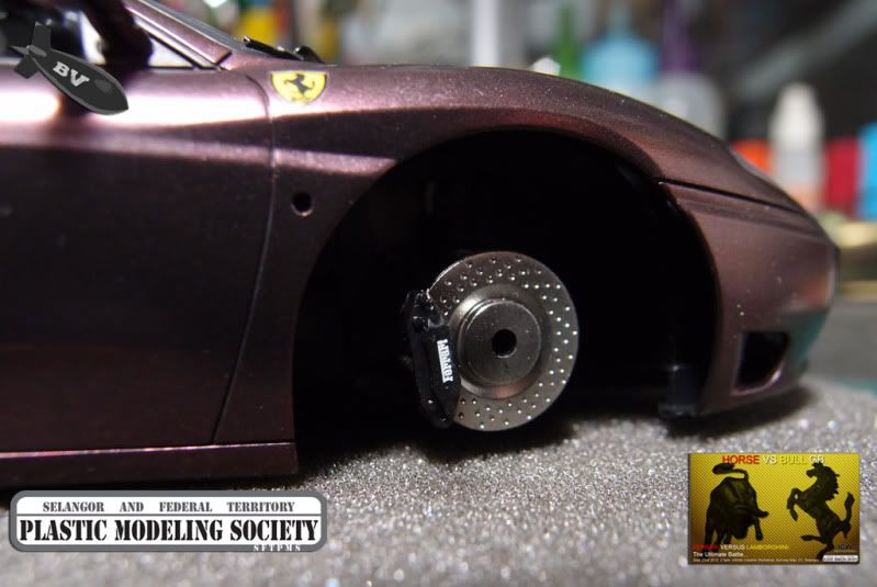

Decals applied on the caliper

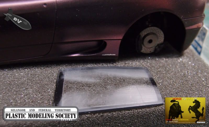

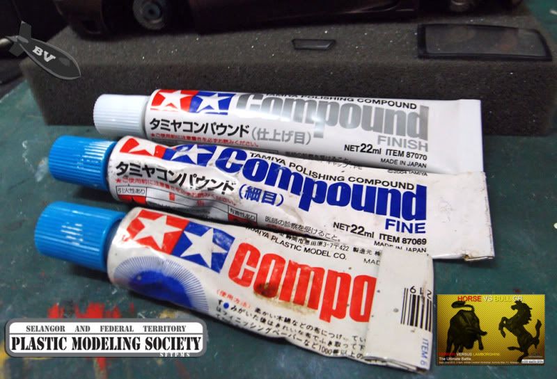

the sink holes were sanded smooth with grid 400 sandpaper
result after 800, 1000, 2000, 3000, 6000, 8000
final polishing with Tamiya polishing compound, coarse, fine and finishing
final result.

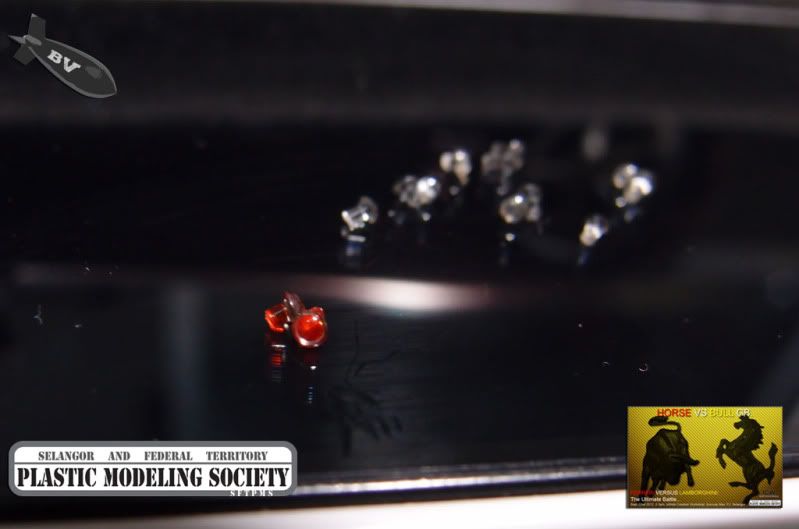

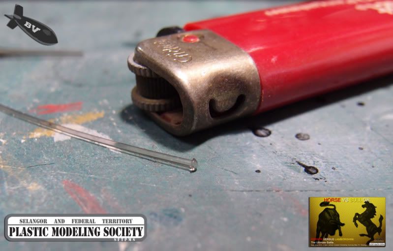

Making of my signal lights.

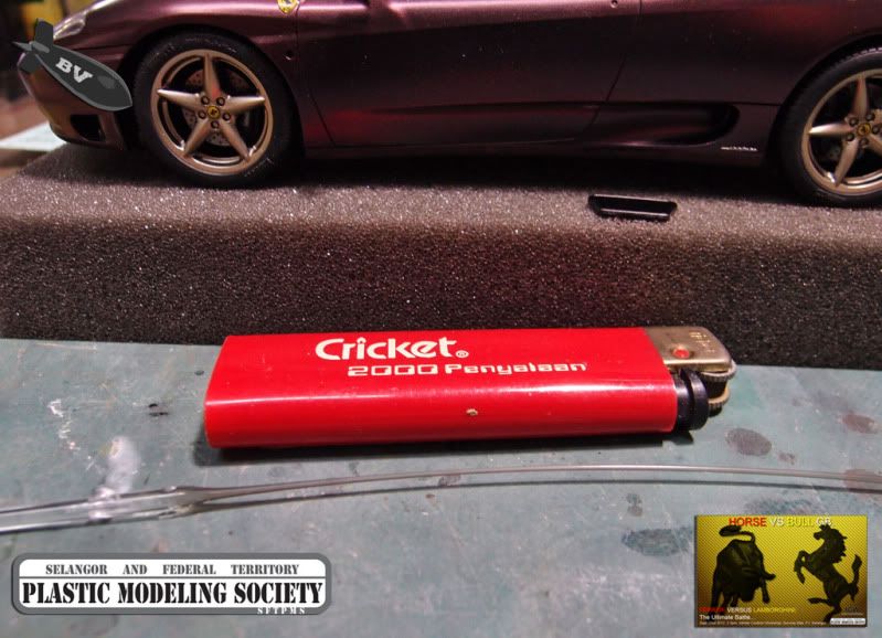

first, I heathen a clear sprue and strech to the desire diameter, personally I prefer Tamiya clear sprue as it's more compact and still looks very clear after stretched
then I I heat up the tip, till it becomes rounded, this took some practice, just cut off the sprue if the shape is not nice
cut out, I did extra for my future build
painted the inner with clear orange
end result.
Thanks for viewing.

regarding the cement seeping onto the clear, you could try to polish it out as well. did mine on a GT-R's headlamp cover, worked.

The red pearl is fron Gunze aka Mr Color GX series, a Japanese brand.
nugundam93
A friend of mine said it's called Midnight Garnet, Infiniti & Ford has this color. For the clear part, I planned to "carbonize" it, already spray black now.
