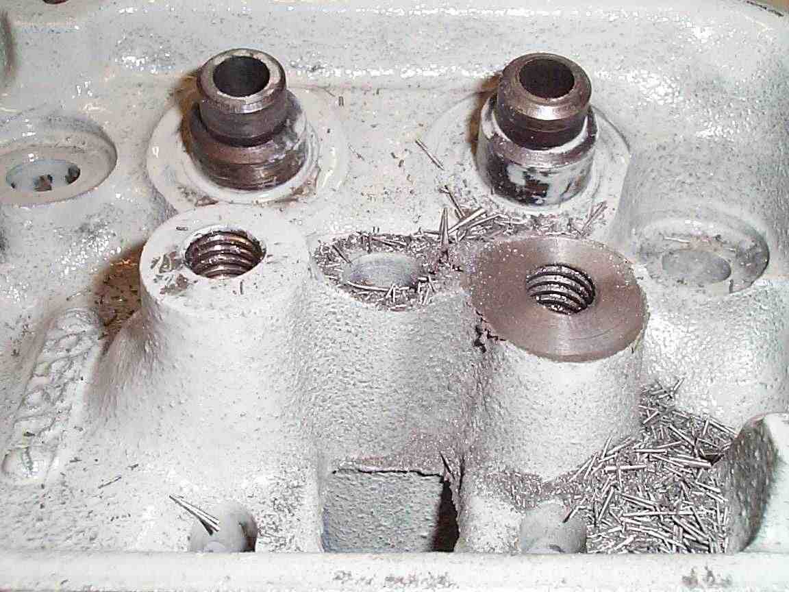

You could tap by hand but would need to be extremely careful to tap straight. That also wouldn't solve the bottom clearance problem for the hex collar on most studs, but you could try to locate collarless studs like Mr. Gasket used to offer.

I'm confused, the heads are already tapped, and, have studs withe hex 'collars'. The only problem is that they are a smaller metric, not 7/16ths. I was concerned about keeping the tap straight though. hmmm, from the pics i think i see what you mean, well, thanks, i guess i'm going to have to do more research.
