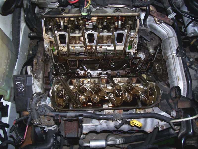

I must be doing it all wrong. I've been able to replace intake gaskets without touching the push rods:

I see that, Butt what about the gasket to go between the head's and the intake manifold? My gasket went under the push rod's. here's what i installed on my 91 lumina with a 3.1
