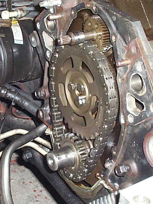

Does your water pump look like this?
That is a stock arrangement. The electrical connector at the lower right is for the coolant temperature sensor. This type water pump is driven via a coupling to the upper camshaft gear through the front of the timing cover (the upper stub shaft in the photo):

Thanks j cat. I hope I did not blow a head gasket. Thanks Blue Bowtie. I did learn yesterday that that is a temp sensor. Yes, mine looks exactly like your picture looks. What do you guys think is happening? May I need a new sensor? What will be my symptoms if I do need one? Is what is happening to my car a common problem in theses cars?
