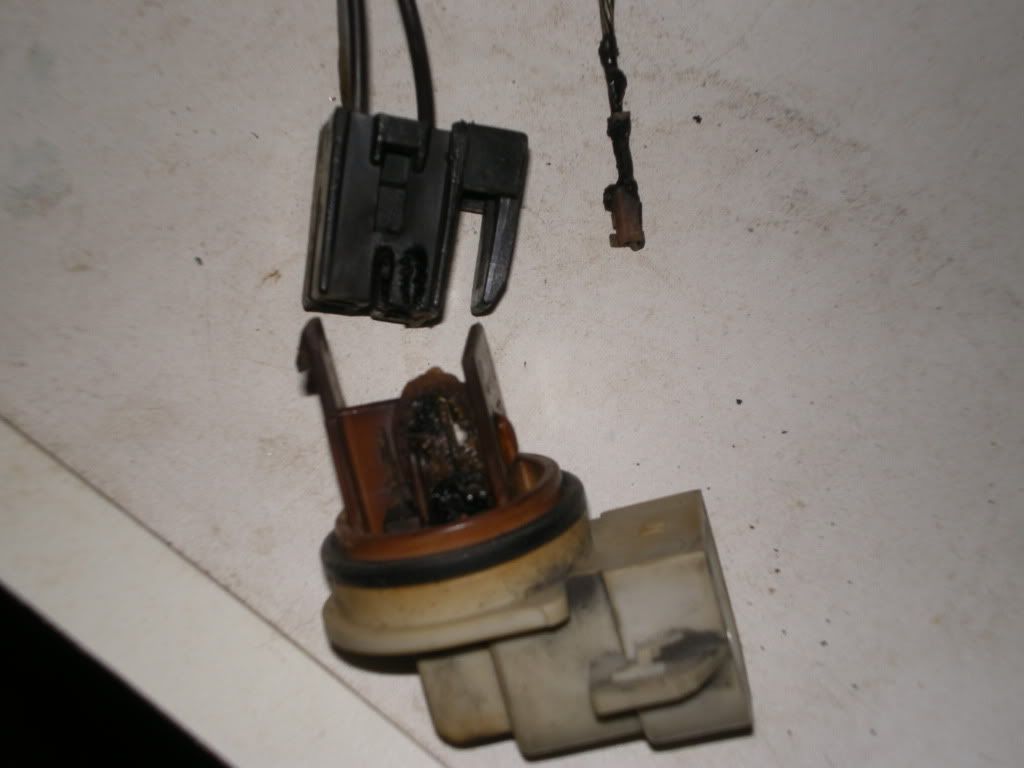

The connector at the fuel pump module is a known issue. It gets hot from high resistance and then melts the connector. Worst case senario... no voltage gets to the fuel pump. In the early stages it can be intermittent.

It finally died again today on the way home from work (of course I was merging at the time ). Anyway, it appears I am heading towards the fuel pump or its electrical connector. As soon as it died, the fuel pressure was 0. This time the engine did not start up right away - took about 5 minutes and several atempts at starting. The fuel pump did not come on when the ignition switch was turned on or via the oil pressure switch ckt while the engine was cranking.
old_master, if the connector is OK do you think it safe to say replace the fuel pump or should I check anything else. I saw a reference to applying a fused 12v supply to the pump's test terminal - is that located in the underhood fuse-relay center and attached to the NC term of the fuel pump relay? If worthwhile, I could possibly be ready to check this when it fails again.

Pulled the gas tank out tonight and found the culprit. The fuel pump electrical connector at the top inside the tank overheated and the terminals were barely making connection. old_master, you hit that one on the head as far as possibly showing up as an intermittent problem before going out completely.
Here is a link to a picture of the conncetor and pigtail assembly.
