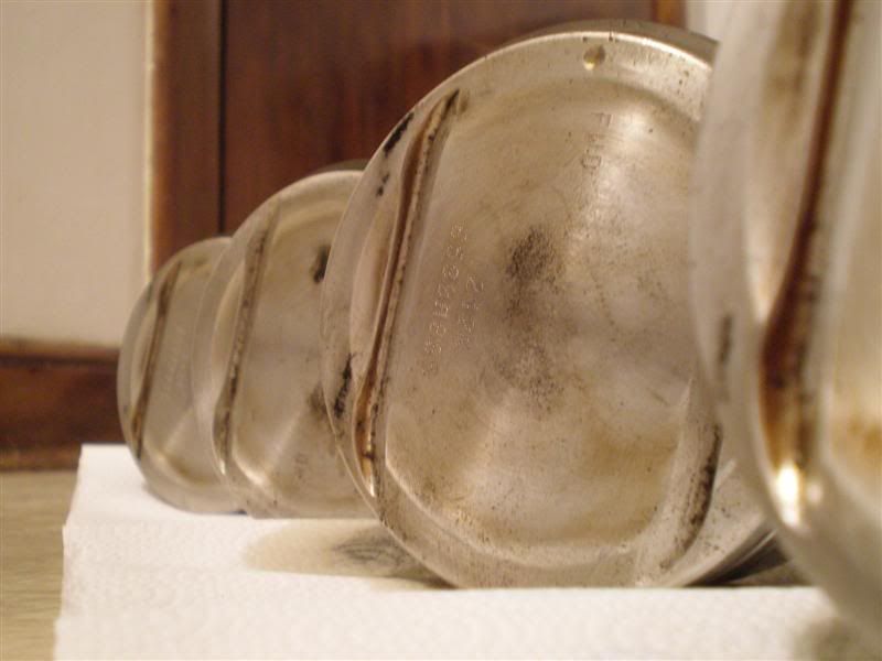

Cylinder walls are in perfect shape. You can see where the rings are being grinded down and there's still cross-hatching. Will still hone it again.
Pistons themself are in great shape as well, no burn, scorns or damage. Rods, caps, and bearings all fine too.

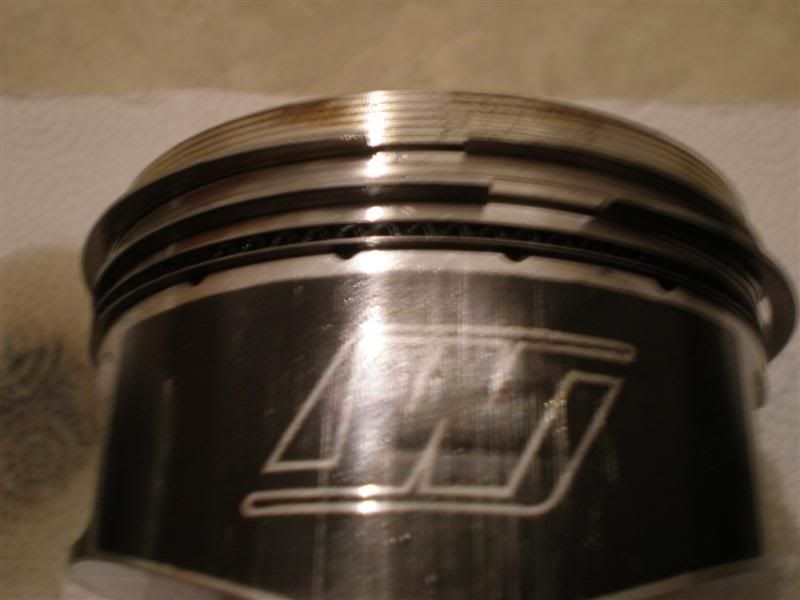

Rings... not aligned properly.
I see 3 gaps on just this one side, which would cause the problems. Not good. Not sure why the car would run perfectly for the start, and then once I started boosting it caused problems. Seems it should have had issues the entire time. But at least there's no damage to anything. I'll re-ring, align (probably have someone double check my work ),hone, and reinstall.

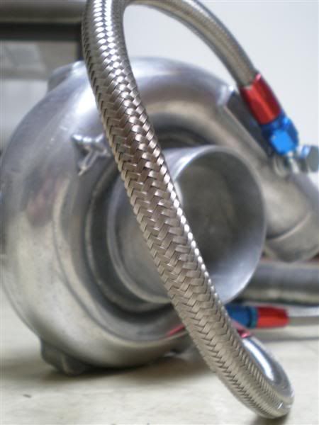

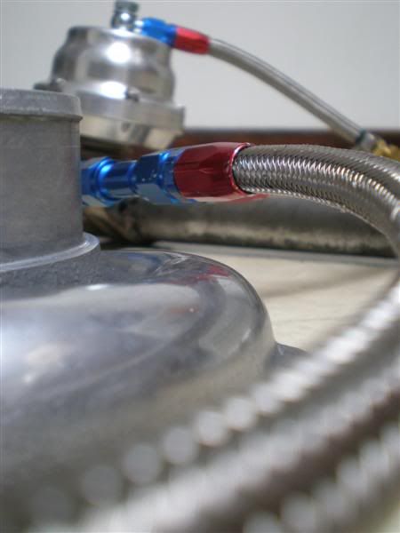

Busted out the camera today and took some real pics of the SS (got bored). Can see the polish job a little better. Not perfect, but good enough for me.

-Re-reringed the pistons
-Honed the cylinders (ps, don't rent anything from AutoZone FYI)
-Pistons back in
-Head/IM bolted down
Did the rings in about an hour. Turned out perfect and the rings are in the right position this time
