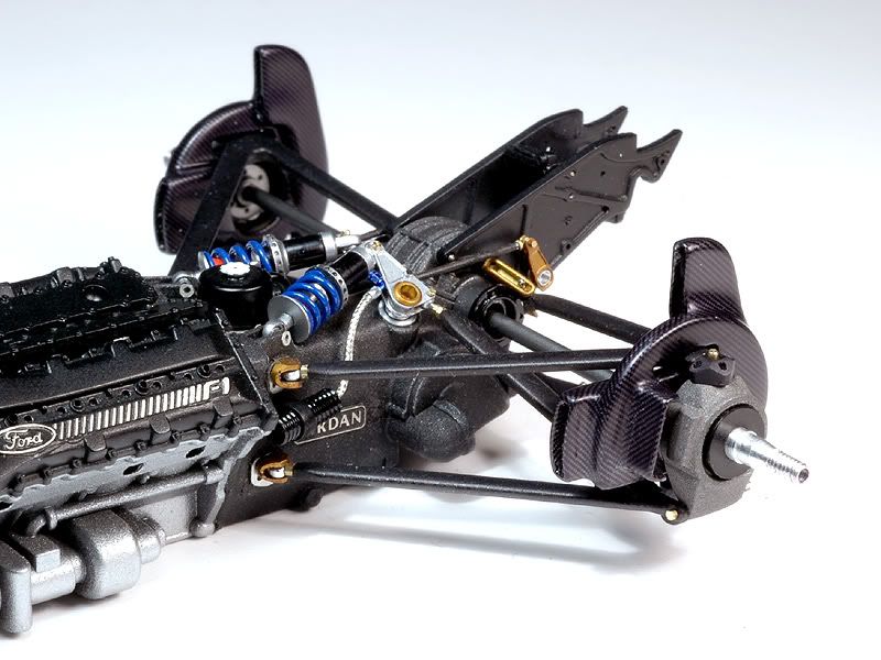

Hi
After a somewhat longer break here’s another update. The reason for this was the suspension I started to install. Despite all my efforts I got fitment and alignment troubles. It’s really amazing and frustrating at the same time how much some paint and glue can mess up parts fit. I have to learn to build with bigger tolerances it seems.
I got so annoyed and angry about all my efforts to do the build as clean as I can go down the crapper that I decided to put the model away for a bit and do other things, or other it might have come to an untimely end :-)
Anyway, I finally got back to it and managed to fix the issues mostly so here we go. For a change after all the cockpit and monocoque stuff I started on the rear suspension.
I started by installing the yellowish/orange looking parts. These were all painted Alclad transparent yellow over a Zero silver base and finished off with a thin layer of matt enamel clear for the anodized look. The little arms of the anti roll bar were connected to the bell cranks with thin painted tubes and rod end details. The arms should be vertical as per the real ones, but in that position they would have collided with the cowling…
Next I installed the rear damper reservoirs and connected them to the dampers with ProTech braided line ( very nice stuff ) and R.B.Motion A/N-Fittings.
Then I could start with the lower suspension arms and pushrods. The Jordan 191 usually gets the credit of being the first F1 car to use CF pushrods. However, when I wanted to put CF decals on the pushrods and started checking reference pictures for the pattern orientation I was surprised to not find any picture of the rear pushrods in CF. It turns out it wasn’t used on the rear ones as the resins of the time couldn’t stand the heat from the exhaust. That sent me into more checking. I only found one useful picture of the front pushrods at Spa in the F1Modeling Schumacher Special but it shows that he didn’t have CF ones! I guess ol’ Eddie Jordan was afraid that stupid pay driver kid might break his costly pushrods and left them off :-)
Anyway, as a result I left the CF decals off and painted all the suspension arms with a mix of Jet Black and some Alclad steel for a hint of metallic sparkle, followed by some matt clear to take off the shine. Below these layers I first put on some paint dots to replicate what I guess are spot welding points. These are visible in all the pictures.
Then I installed the uprights with the brakeducts already glued on, followed by the driveshafts and upper suspension arms. It was quite tricky because there were a lot of ends coming together at the same time and at this point the fitment issues really started…
Anyway, for the record, the uprights are painted in a mix of matt enamel black and aluminium because enamel paint can give a rougher ( cast metal ) look than Zero when airbrushed at high pressure. The brakeducts received the same CF treatment that I previously described and were sanded and lightly polished ( and yes, it took ages to do them but I’m pretty proud about how they turned out :-) The driveshafts are painted Alclad Magnesium over a black base.
Here’s a view of all parts assembled from the top rear. You can see that despite my efforts around the rear wing support things are not perfectly aligned but once the rear wing is in place this will be less visible :-)
Another view of one of the brake ducts. The CF pattern orientation is true to the real one :-)
And finally a view from the rear.
Now I have to get to the front suspension…there are more issues to fix! CU again for that :-)
