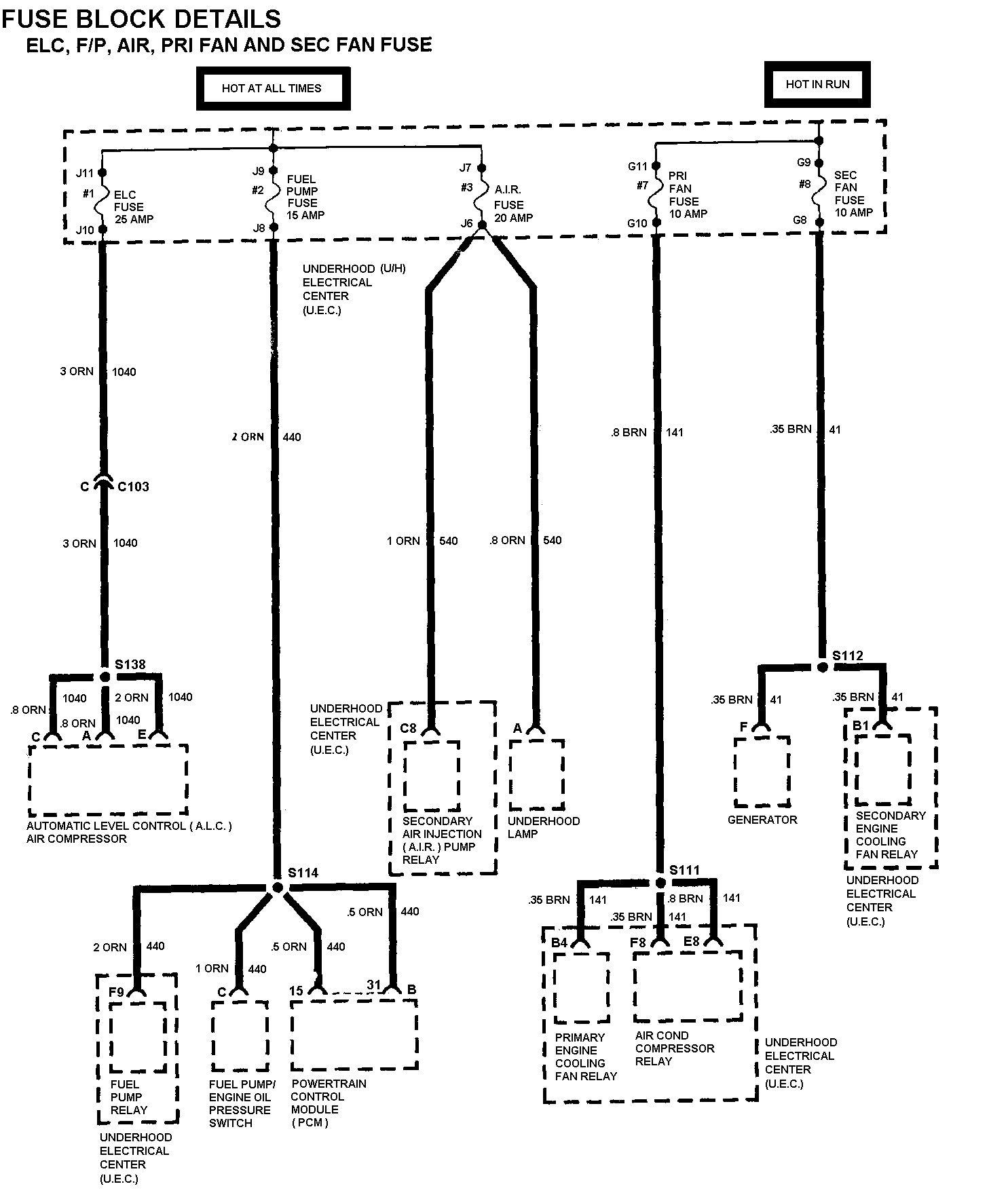

Old 10-10-2009, 11:21 AM
Blue Bowtie's Avatar
Registered Offender
Join Date: Mar 2006
Posts: 6,566
Thanks: 8
Re: 95 Caprice/Impala Hood Light repair

so it then appears that the 1996 year models they made the change over...why bother when they knew it was gonna be the last run ?
my 1996 was built sept 1995 texas ...the OEM manual for the 1996 vehicles ,,,diagram shows the ELC fuse feeding this underhood light ,,,and I confirmed this by pulling the fuse 6inches from the underhood light and it went out...
no wonder GM went under, lost so much profit.
well thats another change made between these years..
thanks for that posting showing this ..
