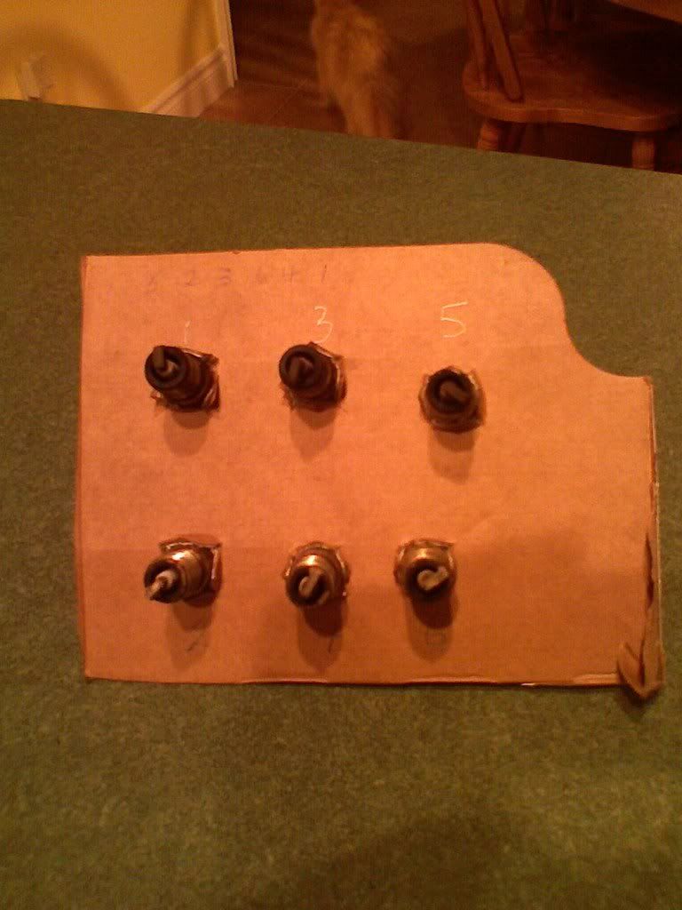

Did all of the routine checks (loose gas cap, etc) prior to deciding that the plugs should come out for replacement. Finally removed all 6 plugs on Sunday and reinstalled new ones.
Was running half decent with a slight miss on Saturday night after removing and replacing the three front plugs.
This led me to believe that I still had not found the root cause and so removing the rear plugs seemed the only solution at that point. Buttoned it up and ran it out of the garage for the night and to think further.
Sunday morning:
B@#ch getting at number one and the boots were on pretty tight, like they had never been removed in 100,000 miles.

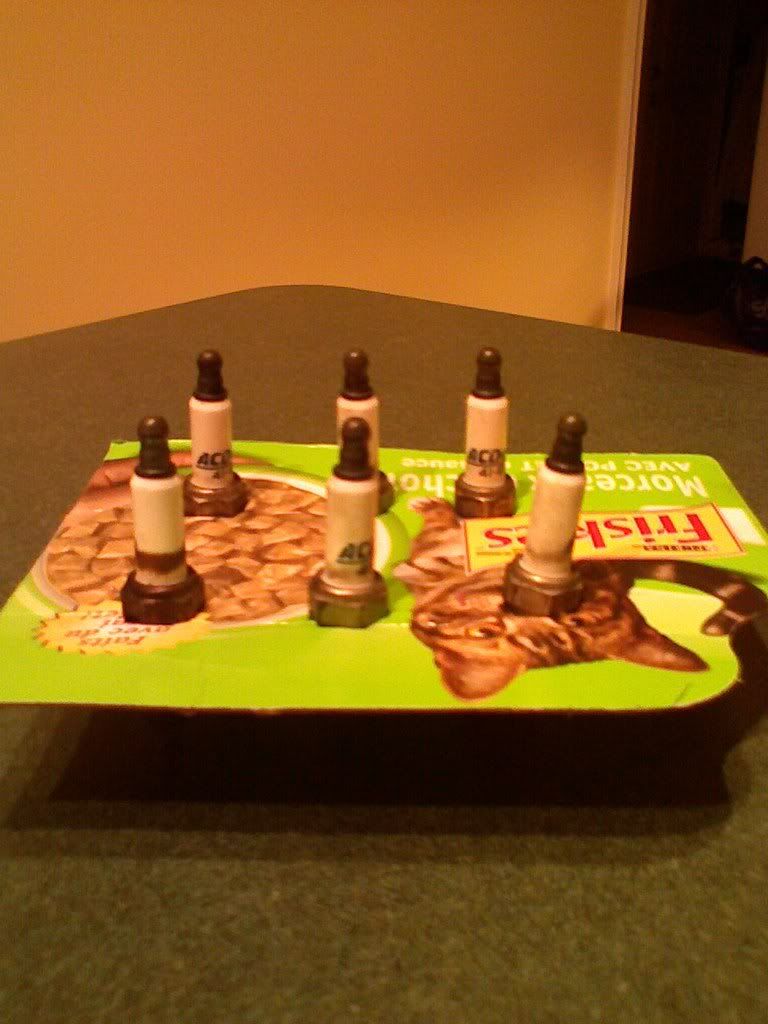

Here's what the plugs looked like:
Notice the significant difference between the bottom row, left bank or front of engine and the rear.
The porcelain electrode on Number one is bubbled and severally discoloured. While this could indicate a plug that was not properly torqued, (will not allow proper heat transfer) it could also indicate a plug that has never been removed either.
The outer porcelain is scorched on Number one:

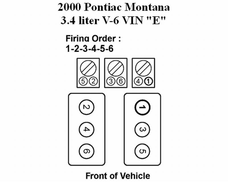

Spark plug wiring diagrams available seem to be somewhat inaccurate, but the routing was checked twice and confirmed to be right.
* Indication of 'Front of Vehicle' should mean front of engine and in this case front should be where cylinders one and two are, RIGHT?
Traced wires from coil packs back to each cylinder...everything lines up. Fortunately the coil packs are numbered too, (although you can't see the numbers once installed - Brilliant GM!)

Not sure if you have a book or what, but your diagram confused me. Here is my attempt at hand diagrams:
This is the view while standing in front of the radiator. Arrow points to passenger side. The smaller box in the rear indicates the coils and the numbers on that box are the plug numbers that should connect in that order.
I'm not sure what plate you are asking about in your post. The coils are bolted onto an aluminum plate that acts as a heat sink and also has the electronics required to fire the coils in sequence. That plate has two connectors on the right and one on the left. Mounted on the same two studs in the rear is a bracket that supports the EVAP solonoid and it has two vacuum lines on its right hand side--one from the purge tank down by the gas tank and one from the engine. It also has an electrical connector. The coil pack has a connection from the crank angle sensor that is just down below the rear exhaust manifold and that cable (two conductors) takes a lot of heat and abuse. It connects to the right side of the coil pack. Should it fail, the ecm can still run the engine somewhat, but the timing will be off and starting will be almost impossible--normally the ecm does not supply timing signals until after the engine starts. Startup is done only with the crank angle sensor.
In my opinion, your plugs look the way they do because nobody ever changed the rear plugs before. The front plugs are likely much newer than the rear. I think you have the firing order messed up somehow now, that's why things are much worse for you. Even if you had arcing going on somewhere, it would still fire the plug somewhat, and you would also hear that as a snap sound.
Double check your firing order before anything else.

Thanks for your detailed reply. Your description confirms what I discovered while rummaging around the rear bank of the engine. I may have accidentally switched one of the coil packs when I disassembled and cleaned them (took the rust of the ground reference that the rear bolt passes through). And I may have accidentally broken a wire while trying to remove it too.
I bought new AC Delco wires and dielectric grease this morning and will check the position of the coil packs too. So that silver gizmo under the packs sandwiched between the plate and the coil packs is the electronic logic unit? OK, thanks for explaining that.
And the EVAP sensor / switch too. Too many wires hanging around down there too, considering the heat they must be subjected to on a long trip.
I know the diagram is mislabeled, but believe it or not, it is readily available on About.com as part of group of vehicle schematics.
