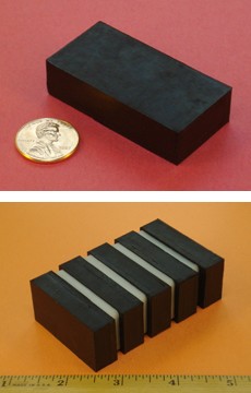

Search for super strong neodymium magnets. http://www.kjmagnetics.com/proddetail.asp?prod=BY0X08BR
