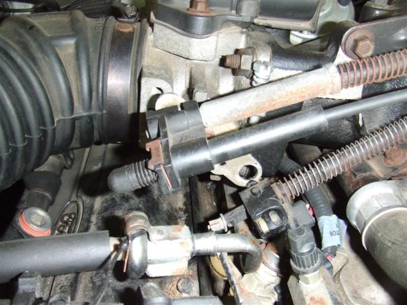

Posts: 53
Re: Trans finally shifts around 7,000 rpm
try this link
http://img.photobucket.com/albums/09...0335Medium.jpg
the top two are gas and cruise, the bottom goes to transmission. It is disconnected and the retaining clip and block are missing, If you don't have the bottom one you should at least see where it connects.
samturner is offline   Reply With Quote

Thanks for the photo. I'll have to upload mine when I get home tonight.
Mine seems to be a little different. Just to clarify, I have a 2000 Cougar with a V6.
That picture looks like it's taken from the front of the vehicle. Where the right side of the picture is actually the left side of the car, correct?
If that's the case, my cables are going in the same direction but are on the other side, closer to the firewall. I’ll get the pic uploaded tonight but it’s going to be late.
