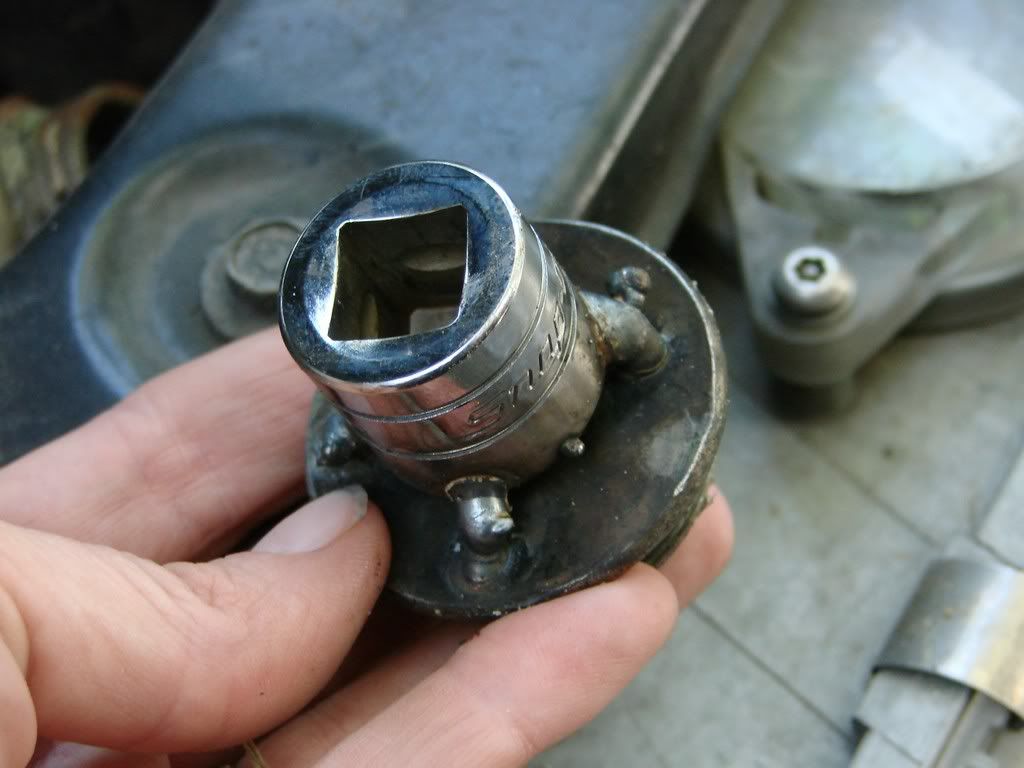

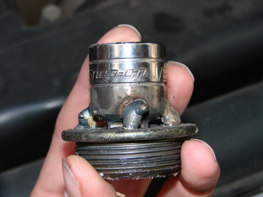

apparently the previous owner had a shop try and replace the clutch and they couldn't get the extension shaft plug out. apparently their 1/2" drive slipped out a couple of times rounding it out. jer got the great idea to have our friend dan weld our 1/2" right to the plug, it was crude but worked...
check out all the "lock tite" pre-loaded on the new plug....!

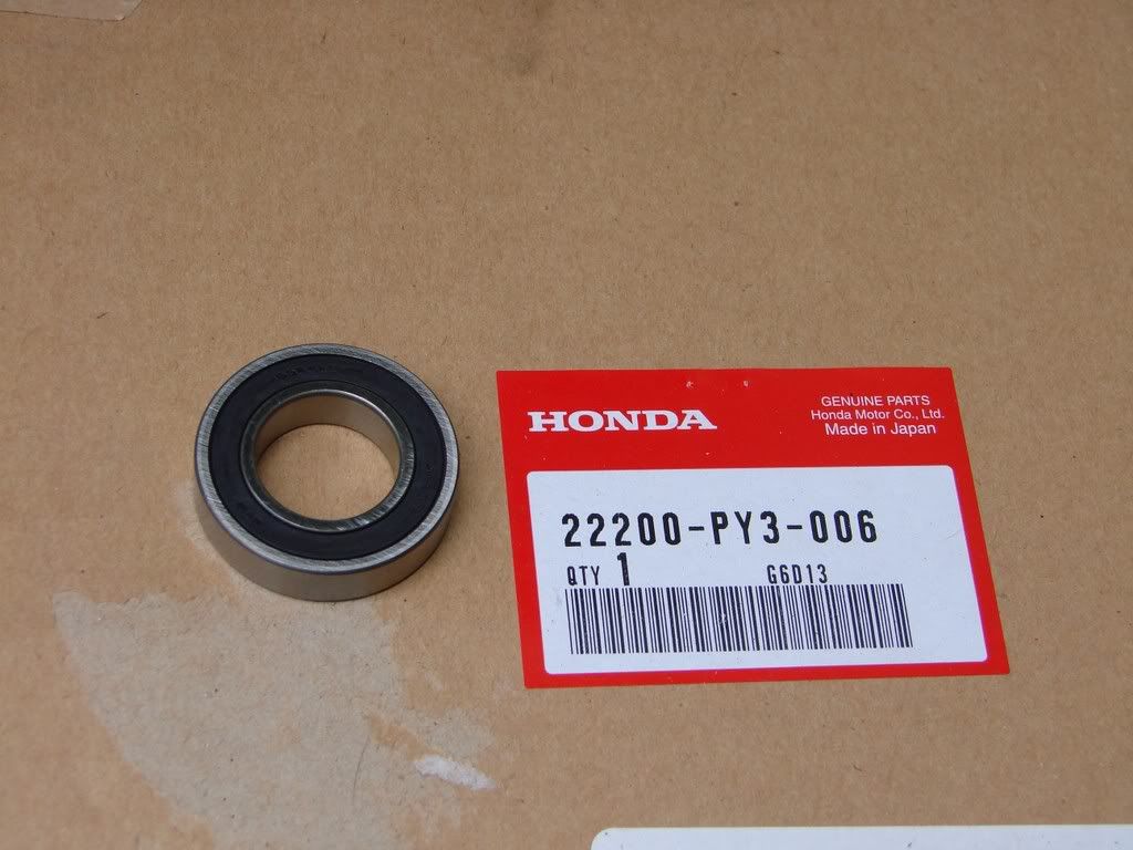

huge pilot bearing...

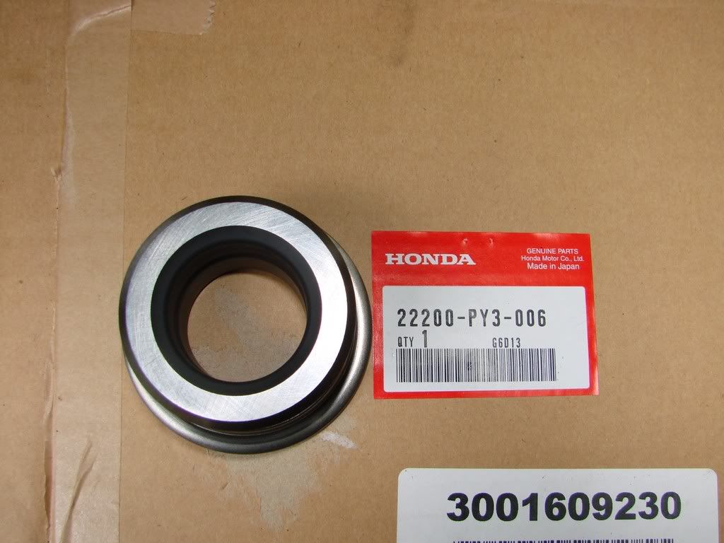

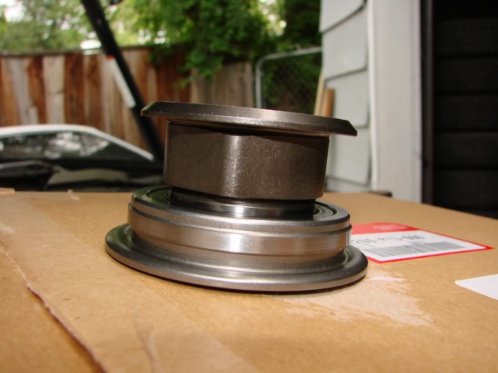

even more massive throw-out bearing...

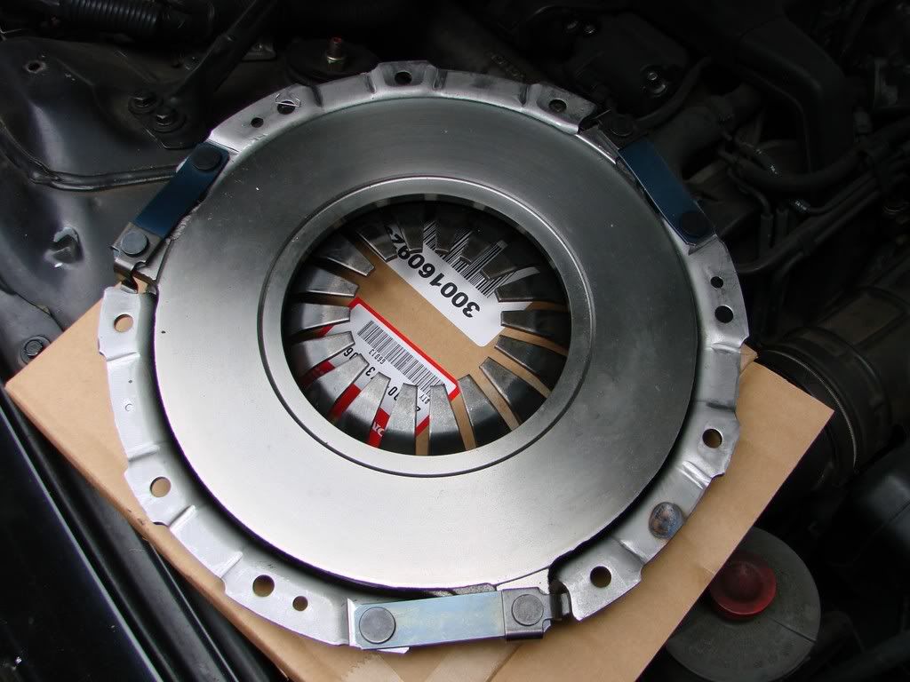

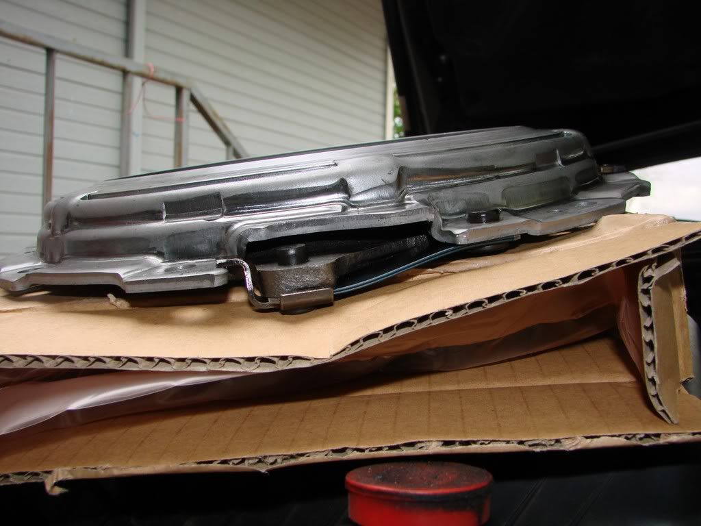

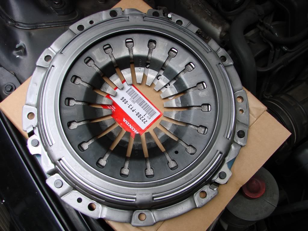

pressure plate...

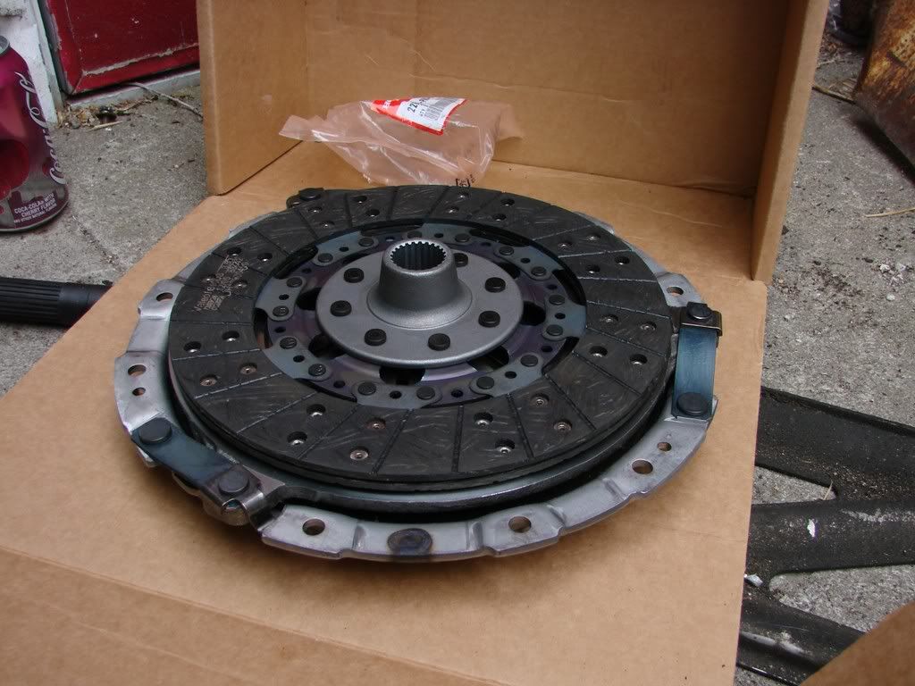

clutch disc...

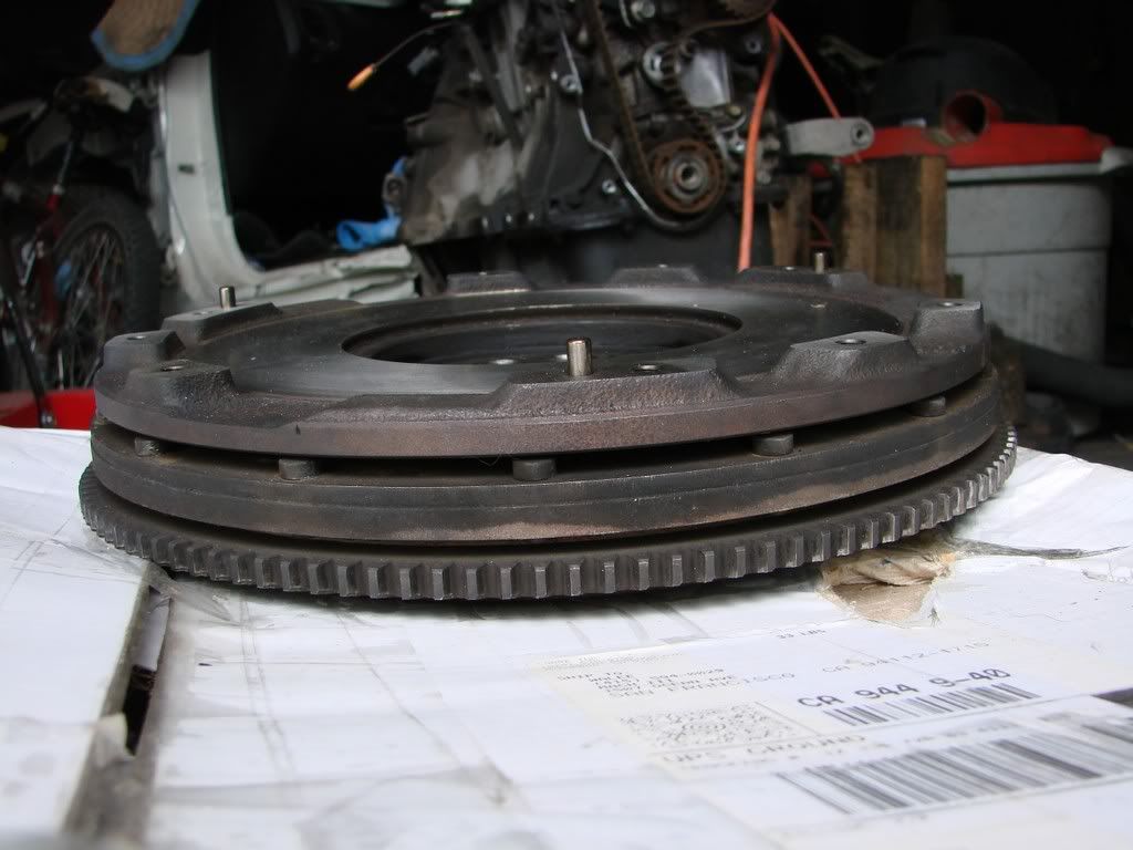

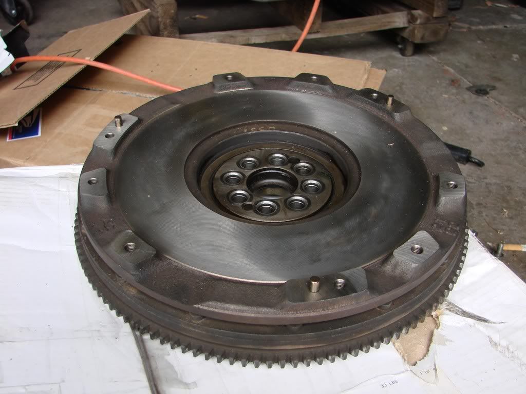

dual mass flywheel. DO NO RESURFACE! this is a pic of the one we had resurfaced and it wouldn't disengauge after we put it back together. no i didn't take a pic of the brand new flywheel, i forgot. d'oh!

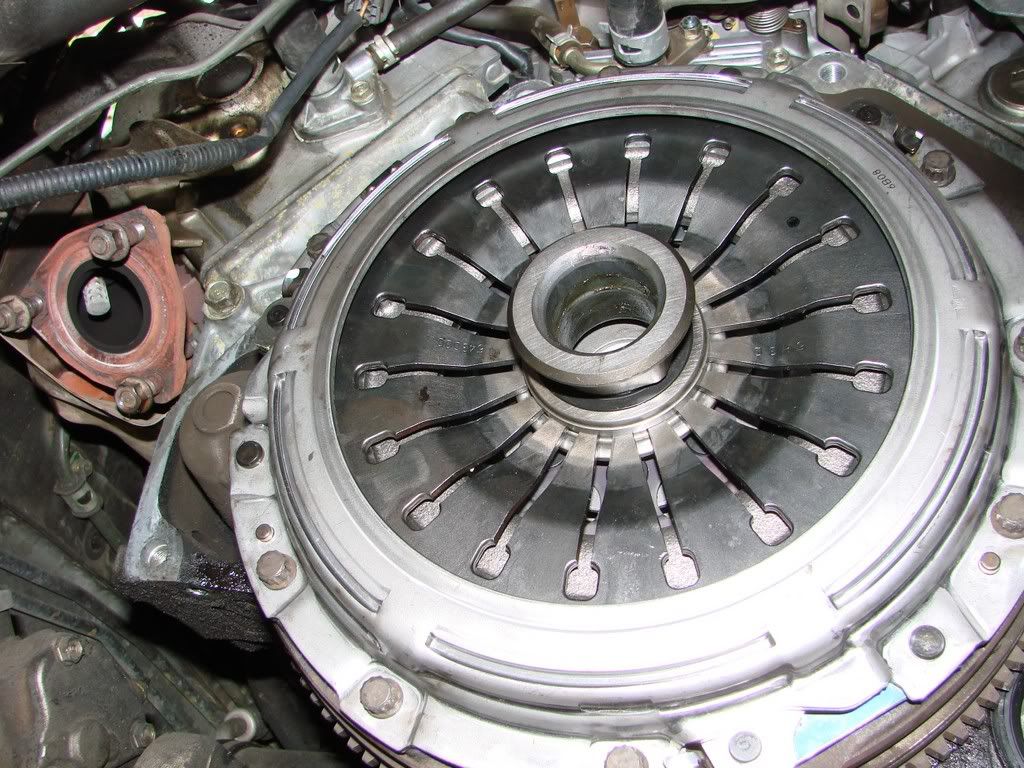

if you've replaced clutches you'll notice this is a backwards set-up. the fork pulls out. the disc sorta floats on the bearing. on the ground this is what it looks like..
this is what it looks like installed in the car...
a sort of side view...

That's an interesting flywheel, I can see how resurfacing would cause a clearance issue... pretty neat...
The clutch pulling out to release is nothing new though... MK3 and MK4 Supra clutches are like that.

the clutch pulling out isn't new, hyundai's have it ....but it's different compared to your average honda/acura. thought i would point it out for the people who hadn't seen it before, being i posted this in the civic section.
