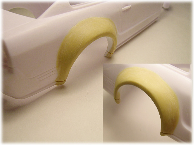

Here are some pics if it helps.

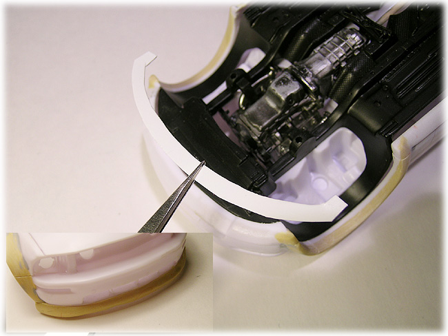

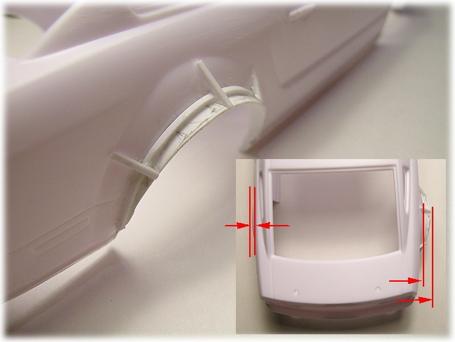

On the other hand, I would like to recommend you to use epoxy putty to do this kind of mod. I understand you didn't like to sand, but it does give you hard surface to shape your way~

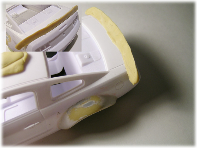

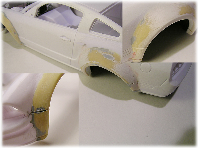

Here are some pictures as to what I did and the result of using epoxy putty to have a wide body... I think you will see that epoxy putty is a good choice for this kind of mod... Good luck~

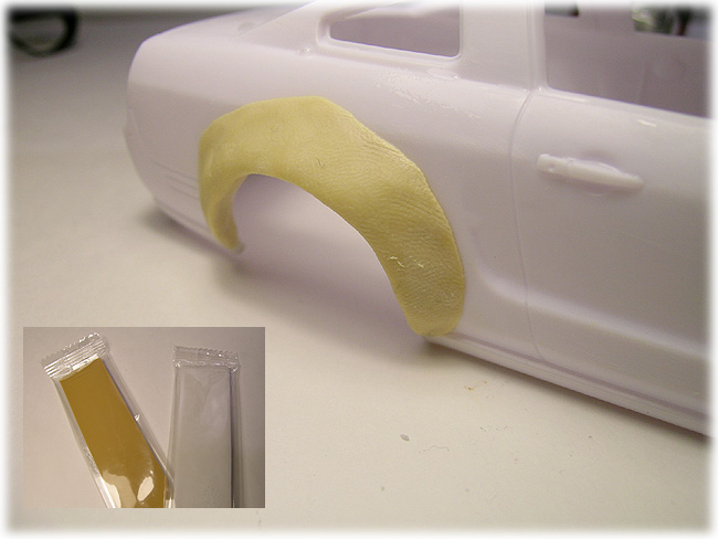

Thank you for the in progress pics! I've switched to a 2 part 5 min epoxy as I don't have the Tamiya epoxy available. That helps to see how it was built up. Mine isn't that elaborate, but I think the results with the epoxy will be superior. What grit did you start sanding with? It seems as though the epoxy won't shrink like the putty did.

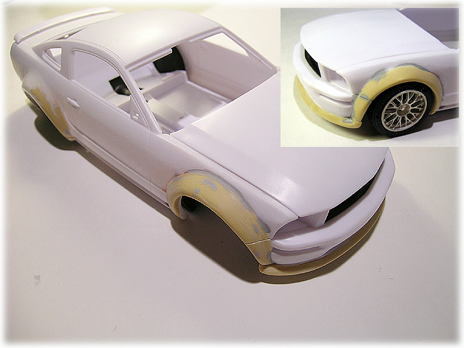

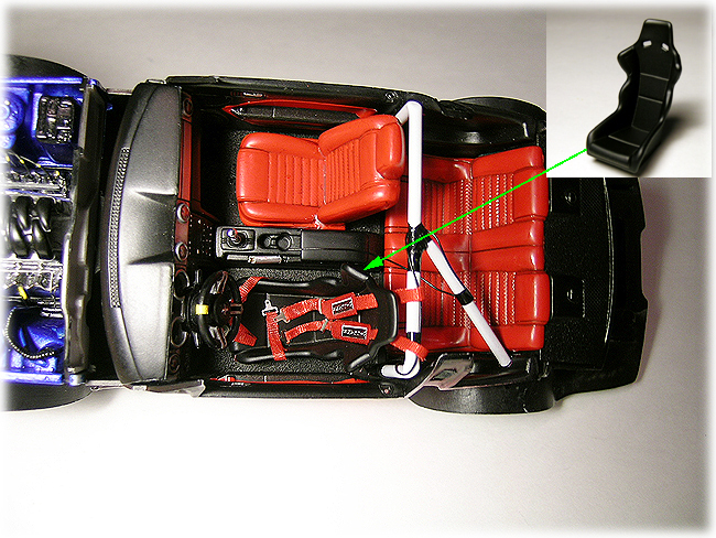

CifeNet, do you have any other in progress pictures? I'd like to see how the front chin spoiler and interior were handled. The stance of that car turned out great.

Thanks for your kind feedback. Just wanted to clarify, you are not using 5min 2 part epoxy "glue" as a putty, right? You would want to use epoxy "putty".
I have a various "files" (metal ones) which I used to shape up. Then I used 320 first, 400, then 1000.
I think I have about 120+ pictures of progress pic, but I never had a time to put together a WIP... I should share...
Let me quickly find some pics that you wanted to see below...
-- CifeNet

The product is called "quicksteel" and it is labeled as a plastic repair tool. You knead the two parts together and then shape it. It isn't a liquid type of epoxy.

Do you have any staight on shots? I'm trying to decide if I should integrate the lower grill or cut it out and have a large opening with mesh behind it.
Thanks in advance for any pictures/tips you can post.
