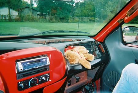

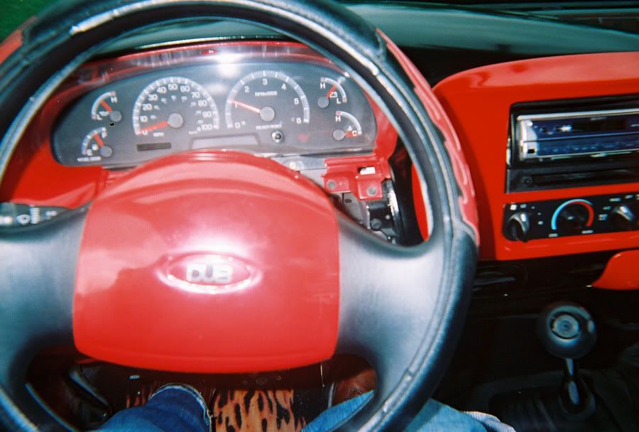

my painted dash
on my '03 f-150

Re: my painted dash
Yes... nice bright colour. What did you do to get them like them... did you sand and prime?

Re: my painted dash
yes, everything was sanded smooth, primed, then house of kolor paint was used, lots of wet sanding and buffing too after clear-lots of work but nice results...everything has to be cleaned before sanding , one to remove oils, then again to remove the mold release agent the factory uses. the radio bezel was fabbed with liquid plastic to fill in vent holes....custom console in progress now
