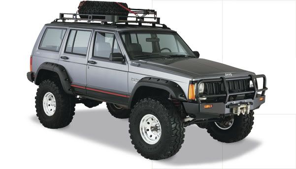

Well, I'm no mechanic, although inclined as such...(I've done a tranny in a camero, LOL) I just don't have the experience yet. Where there's a will there's a Jeep, ay!
The pic is not mine, but rather an example of where I wanna go. Whether I've got to rebuild, trade-in, or put her on a back 'project' burner, I,m going to make my gal soar. So, basically, i want to go as deep as ^she'll^ go, with a snorkle.
I'm going to look into the grills you refferenced. Haven't heard about 'em b4.? They're not like a 14 guage wire bender are they?
I'll be sure to post pics of my various nefarious restults as they happen...
