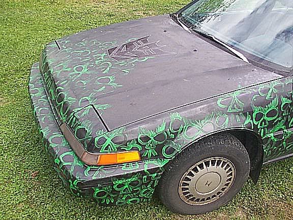

Mike here are a few pics :
My small block project: yes i am keeping that custom paint ..

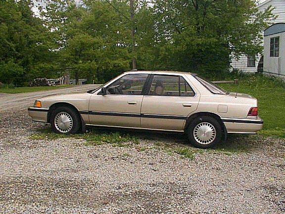

my daily driver acura:

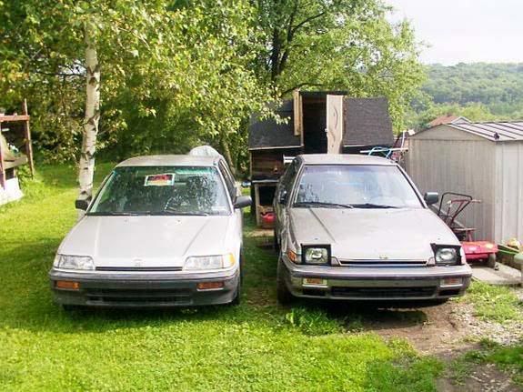

my 2 other rats : no i don't like honda i own 14 of them

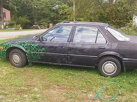

my other toy... like my office :
that car there has a gm 60degree motor it is a mix of 3.1 3.4 3100 3400 small block chevy bearings and rod's forged pistons and there is a bottle on the rear floor
