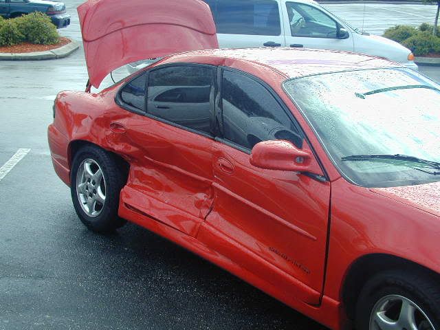

This is the first one I owned. Lady thought she could drive thru it. She was wrong. Full size SUV, 55 MPH. People always want to know why I keep buying them. That's why. I lived. Oh notice, she never broke a window.

Ouch!! What a shame! Do you still have it and is it repaired? You're fortunate it was a 4 door with the center pillar. I don't think a 2 door coupe would have done as well. Did you suffer any injuries?

Walked away from it. But was out of work for about 4 months. The car was dead. What really ticks me off? I let the insurance company take it like it was. I never took a thing from it.
But I did buy a 97 replacement that looked like it twin.
