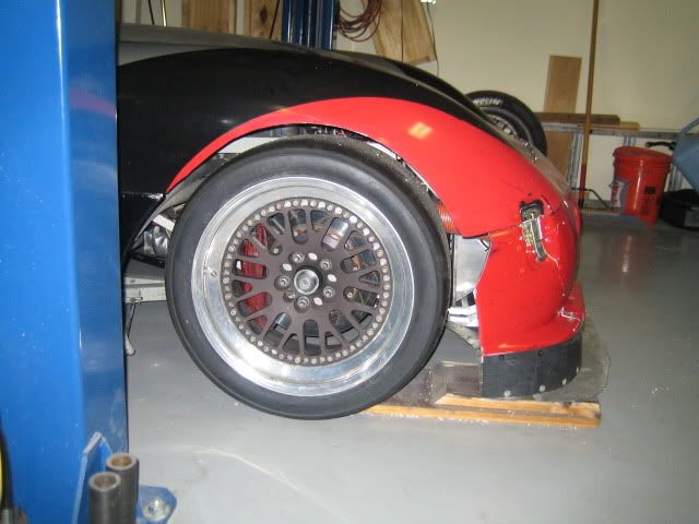

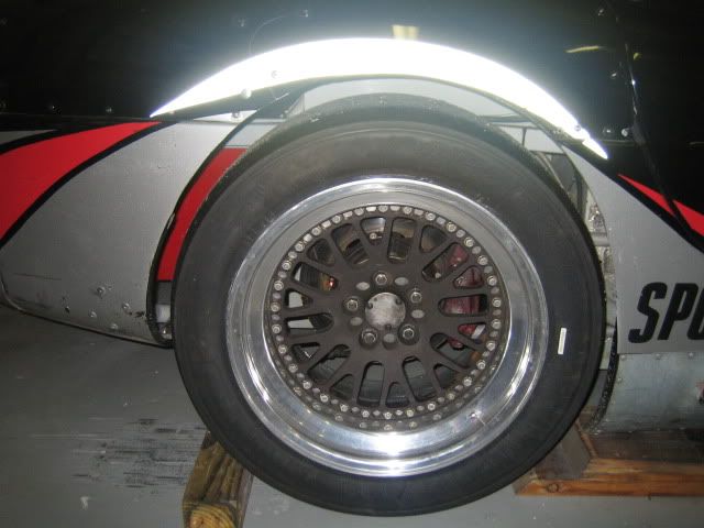

Yeah, the first one got hacksawed and sanded. The second one got folded up. Got it loaded but it's a tight fit in the trailer. It always was close, but now it's really tight! Anyway, here are the pics as the project progressed.
Very nice, wheels look great on the car. Let us know how the lap times compare.
