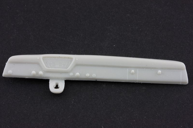

and dashboard
These seats from Porsche (by Fujimi) I was a little pity for this model so I made silicone mold and next resin casting
resin reaches everywhere
and we have beautiful seat
