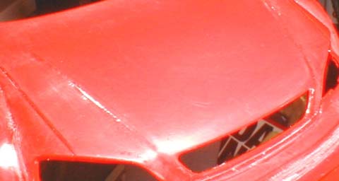

Do you sand thoroughly before using Tamiya compound?
Whatever the brand is, polishing compound has microscopic grains, that scratches the surface to get rid of tiny tiny bumps, that you can't really see. If the bump is too big for the compound to handle, there's visually no effect.
So, you have to sand the surface like the photo below.
In the picture above, you can still see some spots, that the sand paper can't reach.
But in this picture, the center part is thoroughly sanded, and it's reach to polish.
To sand the body like this, it has to have enough paint thickness. The sand paper, I use is Tamiya 2000 grit. I don't like to sand the body color, so I always apply 7 coats of clear. When sanding, try not to touch the edges or small details, such as washer nozzles.
