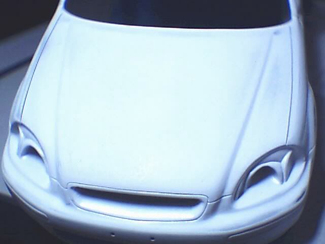

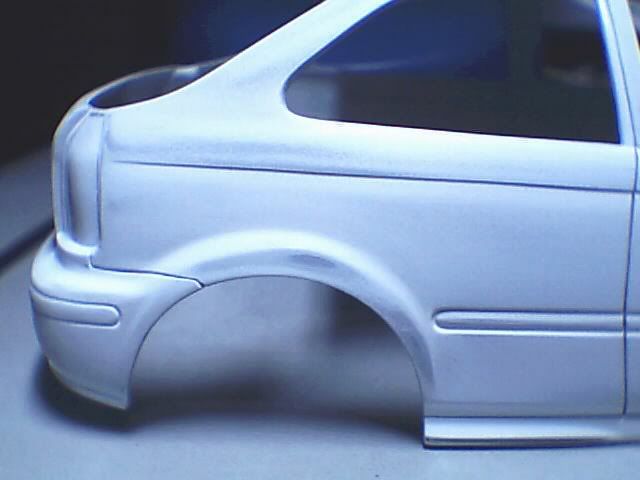

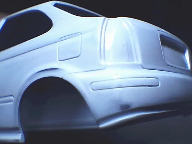

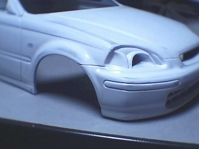

the kit is a civic sir 2, i primer it.. paint it and leave it for 10 days after that it came with an orange peel and then wet sand with a 1000 grit the problem is that i accidentally sand of the paint down to the primer and then it worse.. what should i do? strip the paint and start over again? or could it be fix with a tamiya primer and paint it again?
this one is deeper (above pic)
ps.
3 coats of primer
3 mist coat
4 coats to finish
maybe i paint it too light?

1000 grit sounds a bit too coarse for removing orange peel. The surface looks already smooth, so adding a few more coats of paint shouldn't cause severe orange peel. Use 2000 grit to smooth the surface, and if there's any orange peel you can't remove with it (meaning it's expected to take too much time to do it), use 1500 grit instead.

You should have stopped the moment you rubbed through one area!
1000 grit on a finished paint surface is suicide!
Primer and spray again, there is too much plastic showing to get away with it, especially as you'll rub more on the high points again.
You can primer over the current paint with no problems, but next time use a cutting compound and not papers unless it is the polishing system, but even that will rub through unless you are soooooooooo careful!

Precisely. This is what the body should have looked like after sanding the first coats of primer, not the finished coats of paint. Too many rub-through's now, it must be reprimed. As it is now, it's a smooth in-process primer coat.
I would NOT strip the paint; it's smooth enough and the details/panel lines are still crisp. Re-apply the primer as thin as possible, then carefully respray the color, and carefully polish that out.

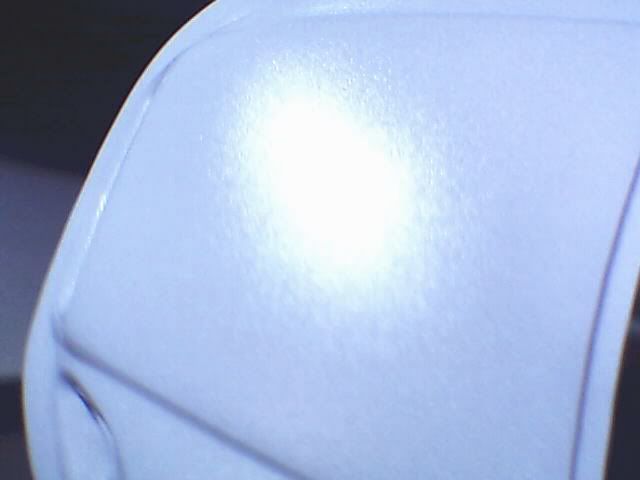

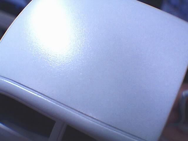

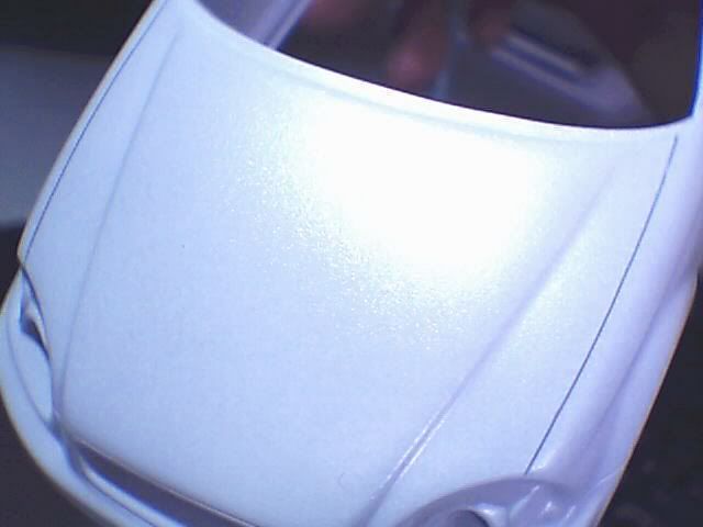

finally i repspray it but theres a little problem.. what do you call this textures? is it an orange peel? it appears after i painted 2 coats of primer and 2 coats of tamiya pure white. and how do i get rid of it..?
Old 08-18-2006, 10:43 PM
Ran's Avatar
Ran Ran is offline
Join Date: Dec 2002
Posts: 3,367
Re: need help.. i ruined the paint!
That looks like orange peel to me. Try wet-sanding with 2000 grit, and if that doesn't remove it - use a 1500 and then 2000... Just please make sure to work slowely and sand a bit at a time so you don't sand through the paint once again.
Edit: don't forget to wait at least a week or two to let the paint dry before sanding and polishing.

Yup, that is indeed orange peel. Remember that a LITTLE orange peel isn't so bad, IMO, because it helps add depth to the paint once it's polished. But as Ran says, you can minimize it with careful wet sanding.
