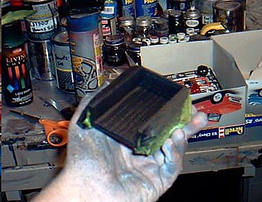

This prolly doesnt consern alot of you, lol, but for the rest of the people, i tried out a can of truck bed coating on a truck model of mine to see if it looked any better than just spraying it flat black, and it worked pretty good actually. If you try this hold the can back as far as you can, so there is just like overspray going onto the bed, this makes the roughness look in scale, i put 2 coats on and i didnt fill up the bed rails at all, and looks pretty cool. I used Dupli-color's version, but there are lots out there. I have some pics belo that i took with my shitty camera so bear with them. Just an idea....

THANK YOU THATS WHAT IVE BEEN LOOKING FOR!!

sweet!!, looks like you got some on your hand!!

May I suggest you try a painting jig to hold your parts while painting?

Yeah, i think i need to put P-man's idea to some use. Off to get some today!
