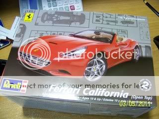

I'm new to car modelling so I have a few inquiries to ask. First of all, can I just use any primer, spray paint, and clear coat designed for plastic? The kit I chose is the Revell Ferrari California, so which parts should I spray and which parts should I use a paint brush? And since the engine compartment is black on the car, would I mask off the engine compartment when painting the body? Help is greatly appreciated, thanks in advance.

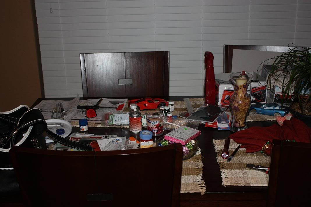

Stay away from enamel for the main body. Lacquer, especially the tamiya spray cans, will be the easiest way to achieve a decent paint job for non-pro/non-airbrush modelers (like us).
Good luck with the Cali. I'm working on an Enzo after a good 5 year break from modeling. Our brand new dining room table has been taken over by modeling gear..
