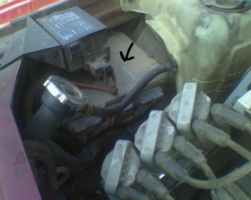

Do you mean this?
http://i397.photobucket.com/albums/p...321111705c.jpg
Dad is looking at me incredulously now for three reasons.
A: it's too easy to get to. People want $1000 to replace it, so he expects to take the car halfway apart to get to the problem.
B: All the "computers" he's been shown at the parts house either had two connections or four. This one has three..
and
C: he was told that this is the airbag control module.
TechTranslator is offline   Reply With Quote

Yes, that is the PCM/Engine Computer, I've attached a diagram to show your Father. My Father has a '95 regal and it is in the same spot. Anybody who would charge $1000 to replace one of these is just taking you to the cleaners. A reman unit should not cost much more than $200 and one from a salvage yard would be much cheaper (I bought a spare unit for the '95 just in case from a salvage yard for $50) and they don't even have to be programmed like the newer ones just switch out the prom chip from the old one to the replacement and you are good to go. Unfortunately the parts store is showing him the wrong units and whomever said that it is the airbag module is mistaken, that module is under the left side of the instrument panel.
