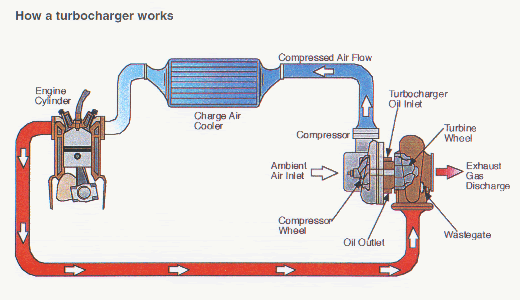

I did yhe search for You and here's one quite explainotory pic of turbo layout:
Hope this helps! Now You have connected the IC where the Downpipe (=exhaust pipe) should go i.e. You have attached the turbocharger wrong way.

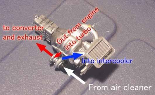

Using the colors in the diagram above, I modified your picture, so you can work from there.
