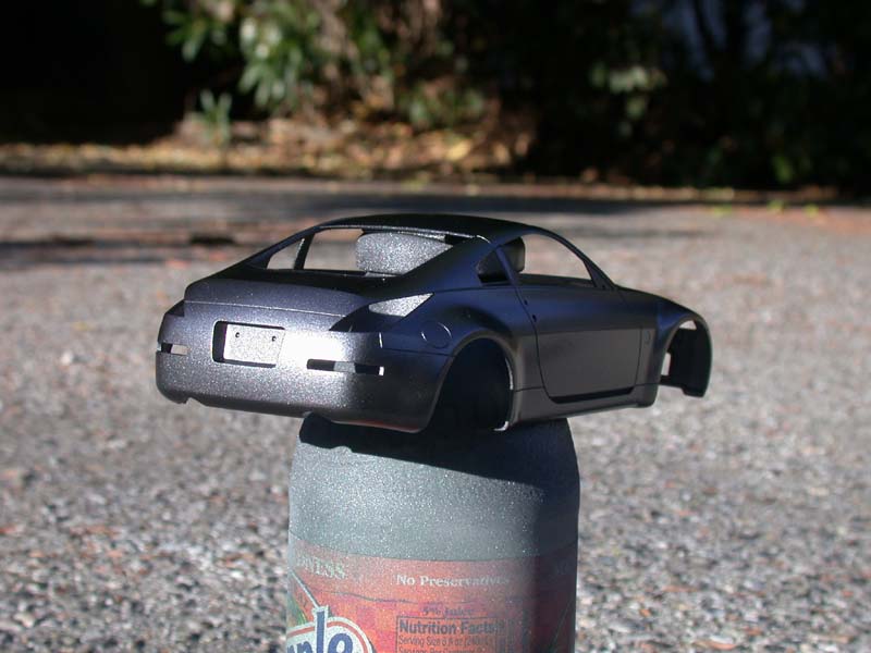

Haha, when I first typed in the subject, I spelled "metallic" as "metallica"! Anyways, the MINI is almost complete, so I thought I'd get a head start on my next project, which is the Nissan 350Z. My choice of color for this one is TS-38, Gun Metal. I was wondering if Tamiya metallic sprays require a clear coat or will it be shiny enough without one? Can I polish the paint just like any regular opaque color? I was just worried about something weird happening to the metallic flakes. Finally, if I do need to add a clear coat, should I polish/sand the base coat so that it's smooth when I add the clear?
I know you guys love pictures, so here is what it looks like after a couple of coats:

If it was me i'd go for the rubbing compound followed by a good wax. This should be enough to give it a good shine.
Remember you wont get a really deep shine as you do with other paints as it's the flakes in the paint that will give it a "different" look.

Clear Coat it!
Im of the opinion that u should clear coat
Especially over a metallic paint.
This will add depth and shine to ur model.
You have nice even paint coverage at the moment on the model
So i would clear coat over what u have done without sanding or polishing and then polish up the clear cote - You may have found that the metalic is slightly rough in texture - leave this as it will act as an adhesive for the clear.

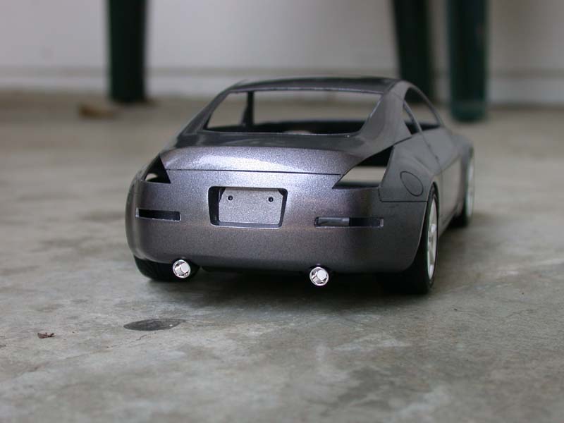

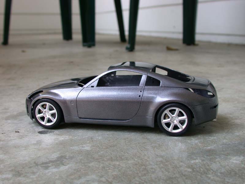

Okay, I think I'm gonna have to go with P-Man on this one. I am quite happy with what a little wet sanding + Tamiya compound (you can still see some in the cracks) has yielded:
Oh, and I'm sorry if this thread is getting a little big for those on dial up. I hope you guys don't mind a few pics here and there.
