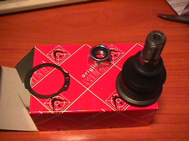

I've got another question. The boot of the ball joint on the lower arem is torn. The manual says that I will pretty much need to replace the whole lower suspension arm! Bwah! Is it possible to replace just the b-joint? What about lower arm bushings?

To answer my own question , NO, you can't get a Nissan balljoint (separately from the lower control arm), but YES you can get one produced by other manufacturer (and it's dirt cheap too!)

The balljoint was 11 bucks

Yes, it's aftermarket, but it's by an unknown company (to me at least) called Sidem I bought it at the dealership. And it really puzzlez me why Nissan won't sell them separately. Tehy are quite easy to remove from the control arm (at least it seems so, but I will find out for sure at the weekend)
Will I need an aligment after replacing the balljoint?

The price of the balljoint was 11 bucks, and the part number is S41483, but I can't see how that would help you as I live in ESTONIA!

Here are a couple of pictures for you:
