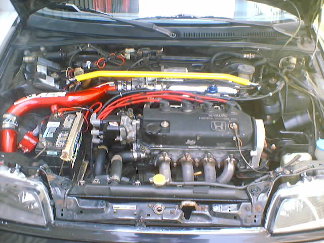

I`m totally new to NOS
I`ll take all advice, I have an 89si with a D16A6 that is fully modded. Please send me in the right direction, I want to run safe at Englishtown without going crazy.
cai/headers/3"exhaust/racing cat/drag manifold/gsr throttle body/msd/apexi s-afc/gude cam/adj cam gears/pulleys/adj fuel reg./chipped ecu/ngk irridiums/low temp stat/
then i have R1 racing seats/auto meter 5" tach/custom black carpet/rockford system/tint/tokico suspension/have a shogun kit sitting in the garage(body work and paint job very soon)/ g3 projectors/carbon tail lights/15" rota slipstreams ACT stage 4 clutch
http://files.automotiveforums.com/up...Picture019.jpg

well safe i say either zex or the venom system. the zex system varies the fuel by bottle pressure....no rich nor lean condition upon activation. on a regular system with button activation....you can either go rich or lean if the bottle pressure is not right. the exh u got on that thing...damn thats huge....i say a safer way would be to just turbo it....less strain on the internals as compared to nitrous upon activation.
