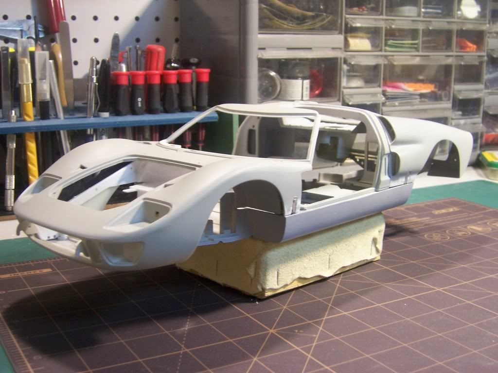

Greetings! I've already been working on this for a while and finally decided to create a post. My goal is to use most of the kit but add a few things mainly from styrene and turned/ machined metal. I've read quite a few reviews and critiques of Trumpeter's kit. I agree with some of the criticisms but also totally disagree with others. I'll explain later.
And a one, and a two......

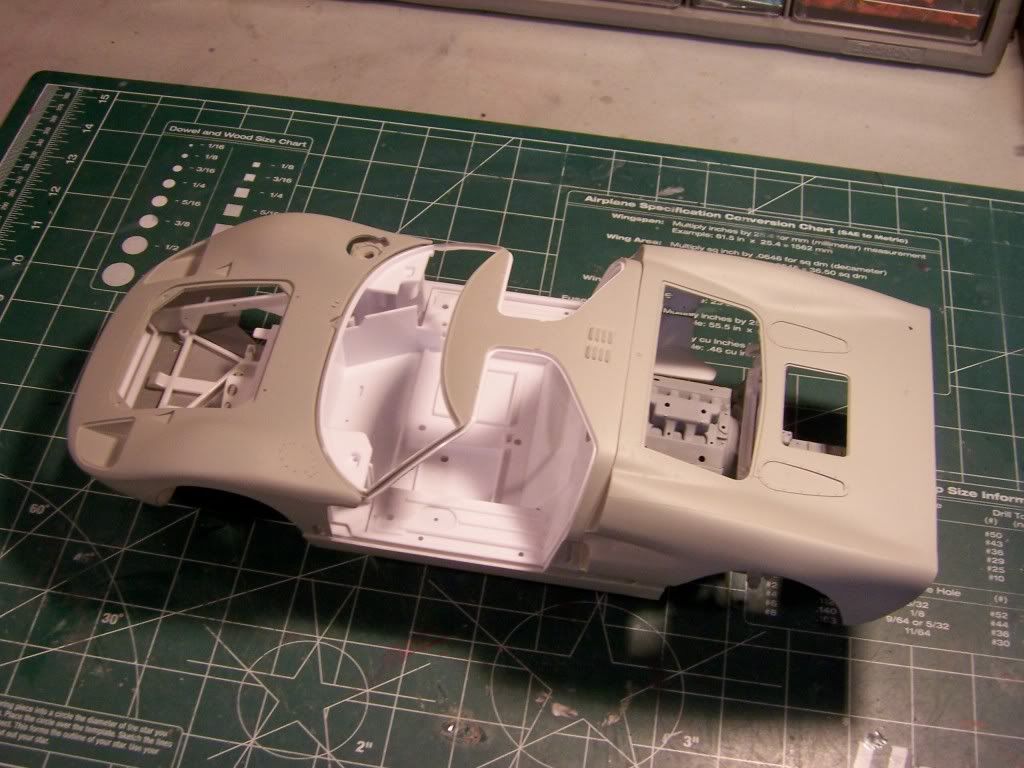

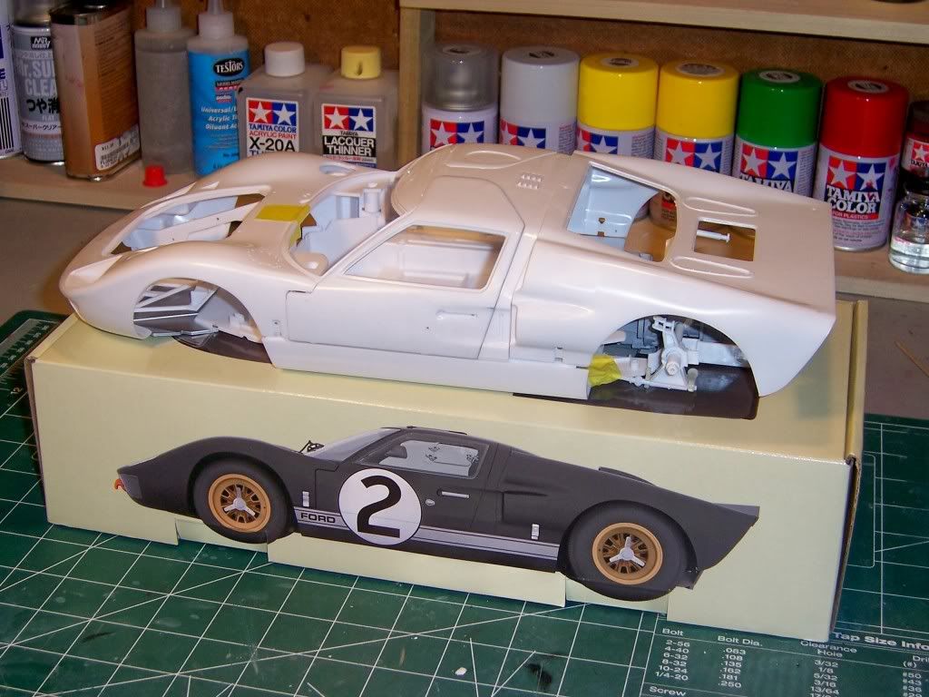

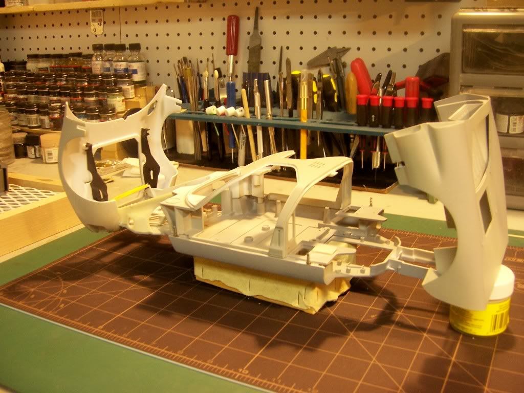

I removed all the parts from their sprues and grouped them based on their location on the car. Yes, there's a ton of parts that needed, in my opinion, the chrome finish removed. This was one of first things I did. I then assembled the whole model using thinned white glue, dismantled and soaked all parts in warm soapy water. This really helped me decided where and how much detail I wanted to add.

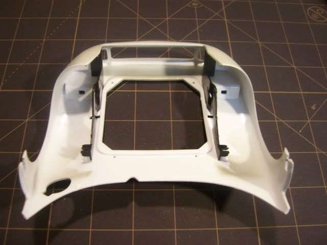

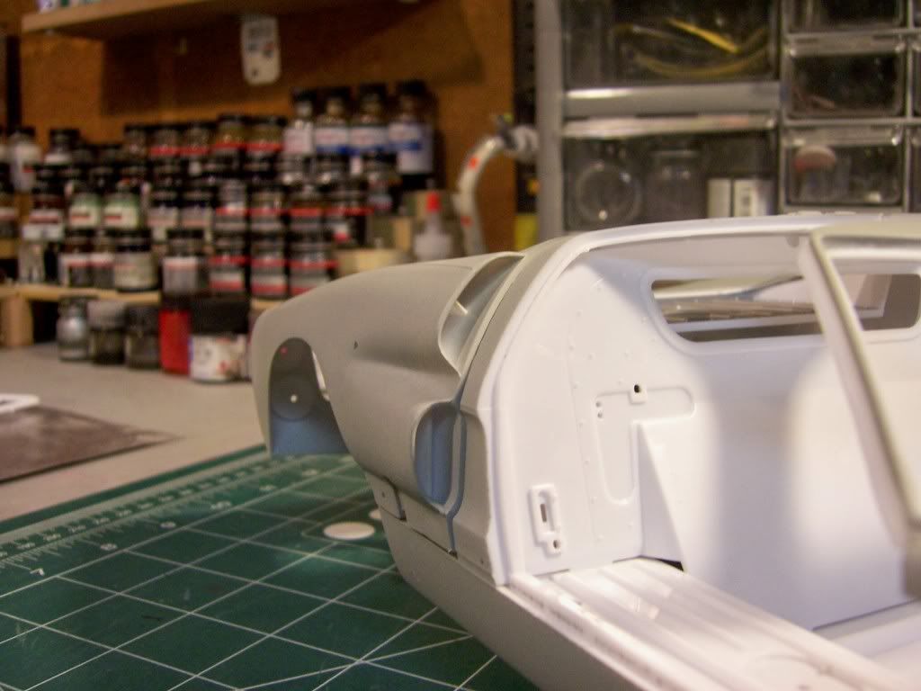

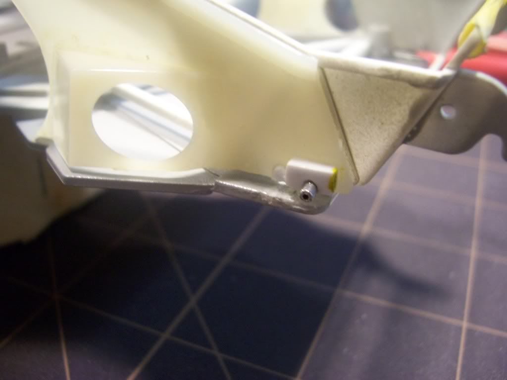

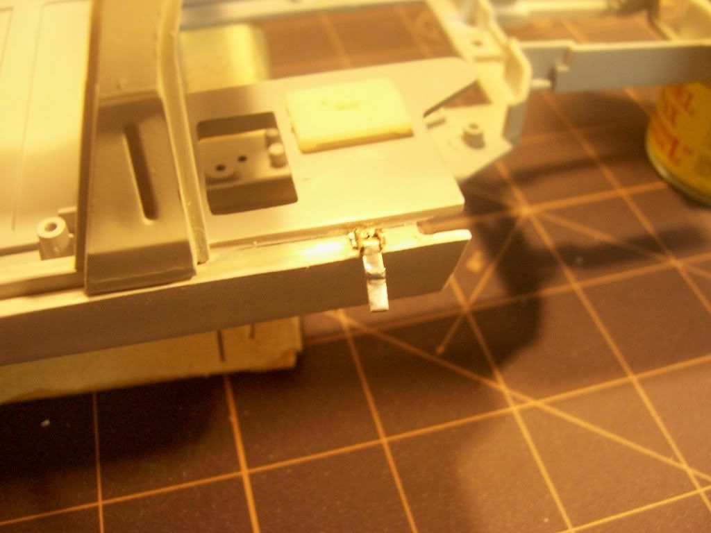

From the get go, I knew I wanted the front clip to clam-shell. Before I started modifying anything, I sat down and drew some ideas on paper and decided on a plan of attack. I discovered the most important thing was to identify where it would pivot. I put the tires/ wheels on and located where everything would attach. The challenge is the pitch of the nose. Too far back, the nose will bottom out before the clip is all the way open.
The black, inner walls assemble underneath-

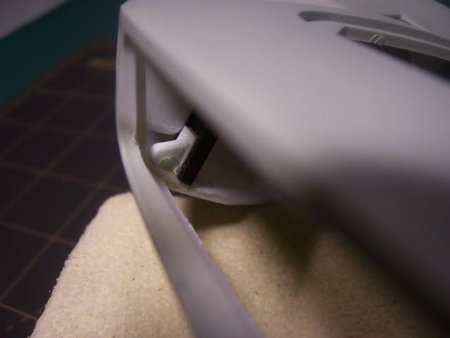

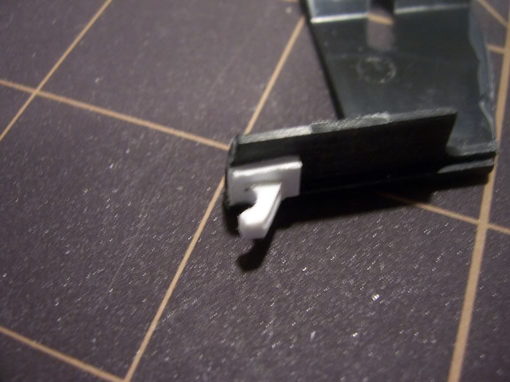

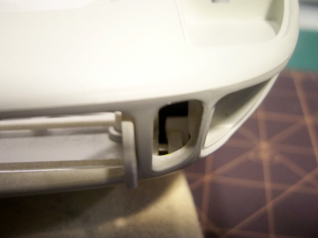

I made catches from styrene and attached them at the front of each piece then test fit each one temporarily installed. Each one had to be sanded down to match the curved profile of the nose bottom.

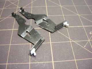

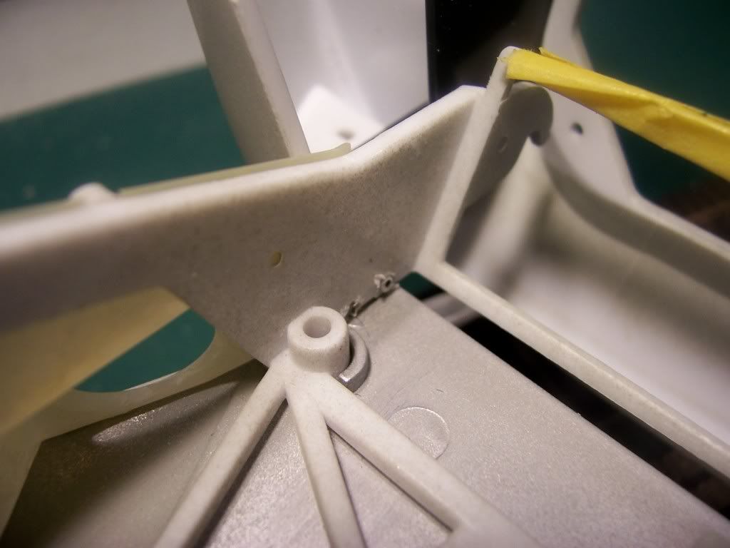

Then, I marked where to drill holes so rod could be inserted underneath the location of where the radiator will go-

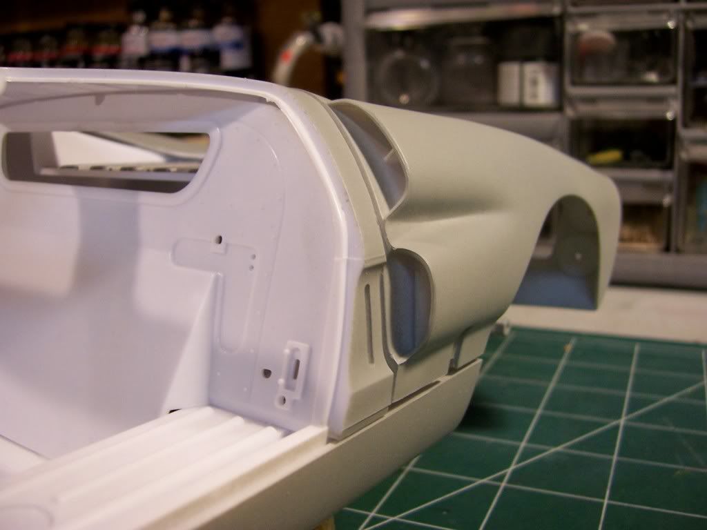

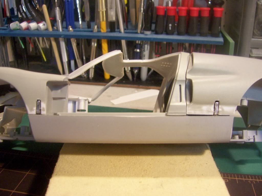

Next, on to the rear clip, errr, the bonnet, I guess...... After test fitting, I realized I needed to pull out the hair dryer-

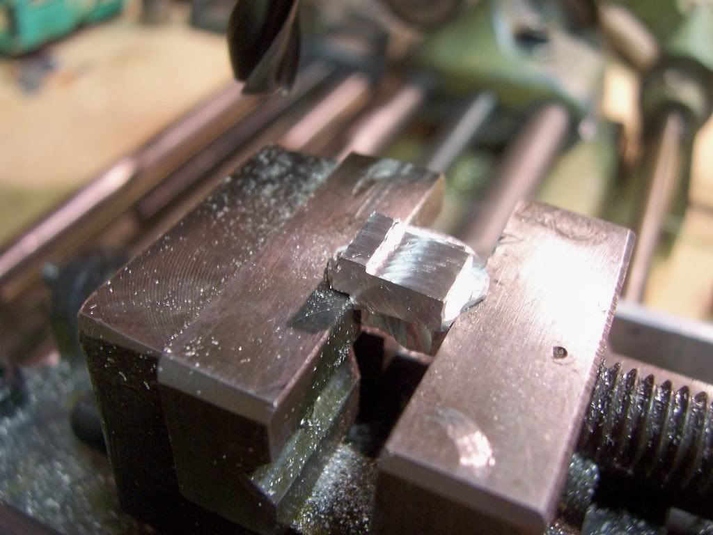

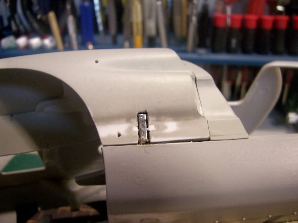

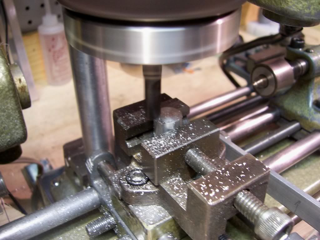

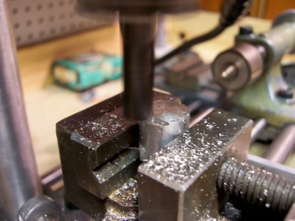

The problem is it doesn't want to sit very well. This was probably my biggest issue with this kit. I didn't like the fact it didn't sit flush and there isn't anything that it clasps to like on the real car. The kit latches are a part of the chrome tree, they're glued to the bonnet. I decided to machine latches from aluminum and kill to birds with one stone.

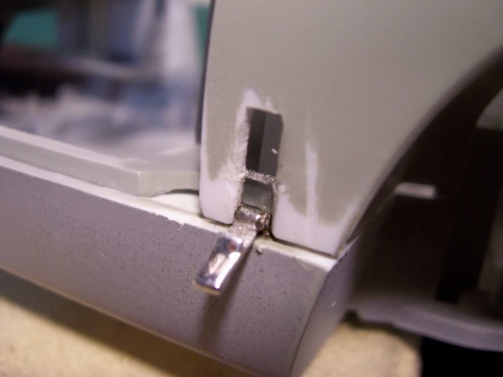

The latch bases were made from brass. The latch and base were connected using music wire soldered in place. Also, the rear was modified so there was room for the base to be attached.

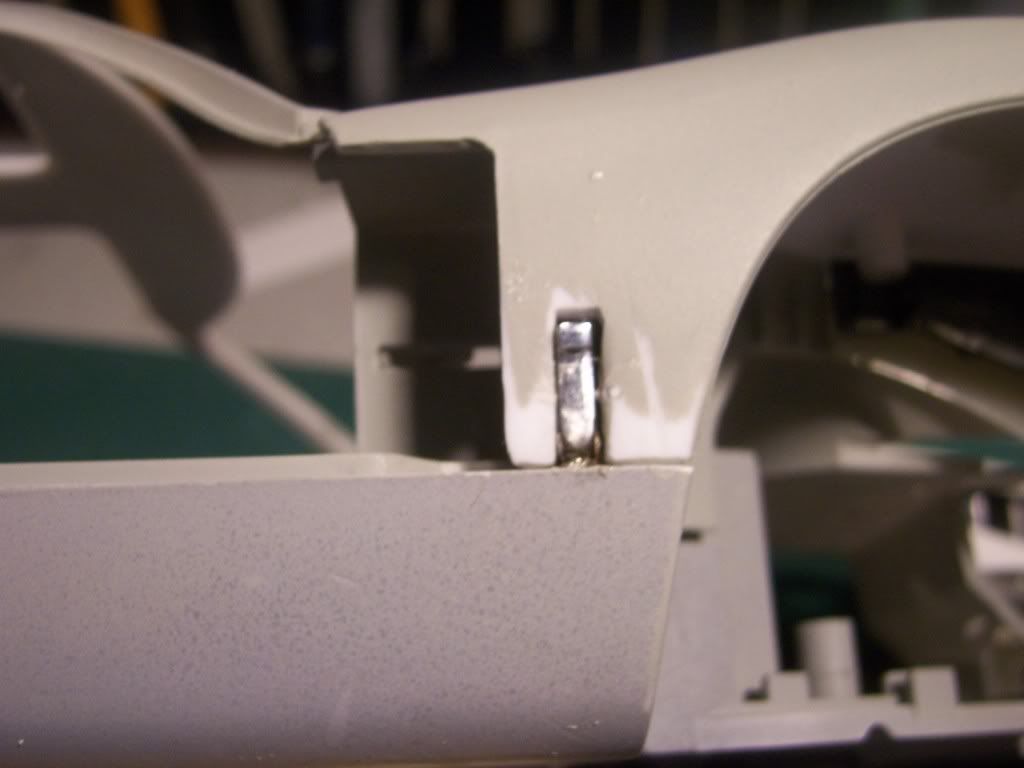

Lots of test fitting, many choice words, about 40 bullets bitten and...........
Latches catch music wire now embedded in the body all around. Also, fully open-

A very excellent start to this build. I completed mine last year and agree about the problems you're addressing.
I'm not a scale machinist as you so my solutions are far more humble. I scratchbuilt much of the rear suspension to get a better look. I added details where visible. I did not solve the clamshell as you did so attached it shut. The oil hatch is open-able and detailed within.
If it's any help to you here's my WIP. Hope you find it useful: :
http://www.modelcarsmag.com/forums/i...p&fromsearch=1
I paid particular attention to the ride height, cockpit, engine bay and finish. I found great reference to be a huge help.
If I do another, I would shim the rear clip bottom edges with .010" stock to get a better shut line-your latches are great but I don't have that talent. A warning about pre-fitting: I found that when the cockpit tub was installed, and the roof section pressed over it, the mating line at the sill was difficult to get flush. I think another solution to the fit of the rear clip is to remove material from the inner upper edge where the clip rests on the roof tab-allowing the lower edges to seat more flush. General fit elsewhere on mine was good. Since completion, I've made small refinements such as replacing the clip hold down lanyards with .006" wire and small paint touch ups.

Thinking back on my build, another area for caution is the fit of the rear clip after the inner arch panel is bonded to it. It will either spread or pull the clip in tighter, changing it's shape.
If you haven't gotten to that point yet-trial fit the clip in place after the arch is white-glued and firmly clamped together.
Then check to see if your clamps still give a tight shut line.

Thanks again, Merlin. Actually, the inner arch is fitted in the photos posted. I spent some time beefy up the outer edges with styrene after I rounded the rear clip with the hair dryer.
